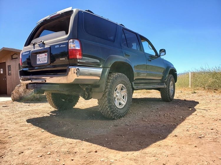

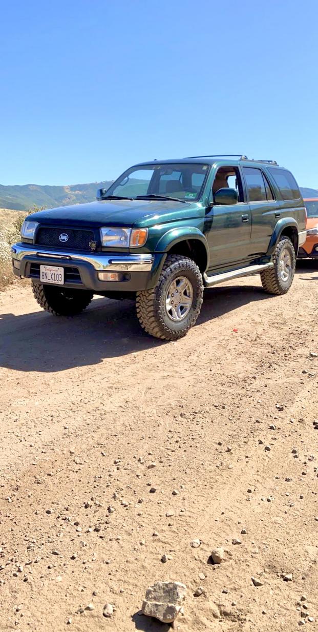

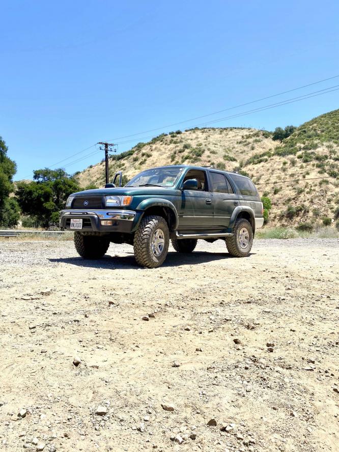

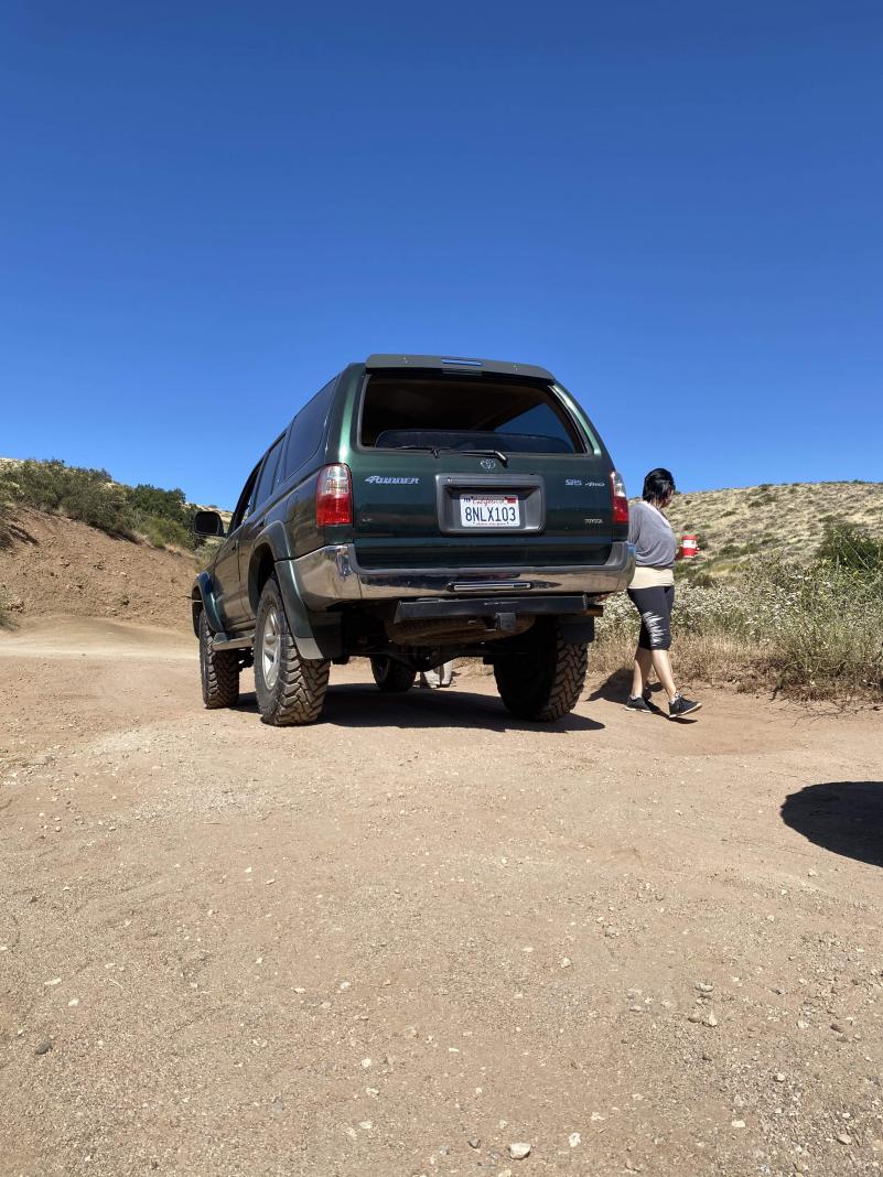

I finished lifting my 2001 and I think the results are great. For the front I used tundra coilovers. I couldn't find the recommended TRD yellow/blue - yellow/yellow ones, but I managed to find a set from a double cab tundra (orange/orange(pass side) - orange/red(driver side)) at a local junkyard. I was expecting this to cause a very harsh ride, however, this is not the case. The car rides great!
For the rear I found the 8.25 wrap lc80 coils (purple/Green/White(driver side) and double purple/light blue/white(passenger side)). I also bought brand new Tokico struts that were originally used for the lc80.
Unfortunately the rear lifted more than I was expecting (~4.5" - 5") and the front lifted less than expected (~0.5" ~ 1") since I did not have the ideal coilovers. So I had a huuuge rake about 3"-3.5". To solve this I put a 2.5" leveling kit in the front from Fat Bobs Garage. This solved the problem and left just enough rake for the rear to settle (especially after I make a new rear bumper).
For tires I decided to go with TOYO M/T Open Country 255/85/R16. It is a 33.5" tire. It clears fine. IMO these "thin" tires look amazing with the 4Runners proportions.
Today I also went off roading for the first time with my dad, mom, and uncle. My uncle came with his lifted Subaru Crosstrek. We took it pretty easy on the trails for the first time but I definitely will try some of the harder stuff when I get more experience.
Pics are attached! :dance:
