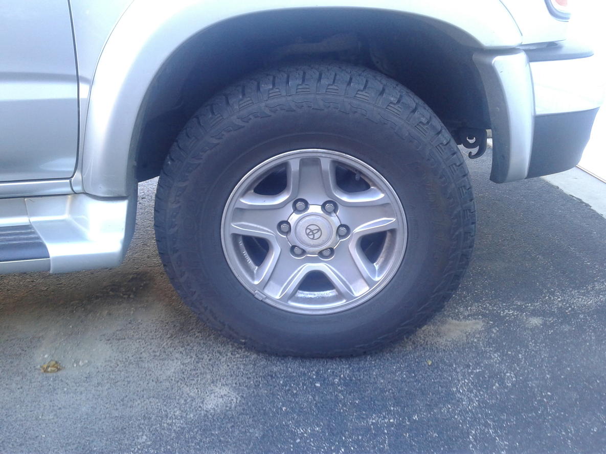

Not all stock 16 inch rims fit over 231mm calipers. Provide a picture of what rims you have and we can tell you if they will work.
Here's the wheel on my '01.
