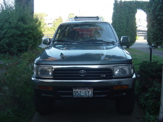

.jpg photo of the runner-
I hope that you can see this image!
