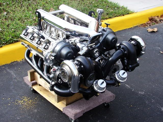

I have seen plenty of 4.7L turbos even twin setups in supras/sc etc. The problem with the 4runner is space. The exhaust manifolds are already very cramped to begin with in stock form; the reason we cant swap manifolds with tundras/sequoias/aftermarket.

You would have to weld in an turbo flange to the factory exhaust manifold which would be really hard considering I believe these are cast iron. Either that or custom fab an entire exhaust manifold for the turbo.
With the v6, it is much easier to install a turbo on since there is more room. There are quite a few people running around with a v6 tacoma, fj, 4runner with turbos.
I dont believe however there is any aftermarket turbo kit for the v6 due to a turbo having to be low boost application without beefing up the internals. It is much most cost/space efficient to go with a loose boost application supercharger, even toyota makes one.
Supercharger kits exist for both the v6 and v8 which is accomplishes the same thing as a low boost turbo without the lag.
