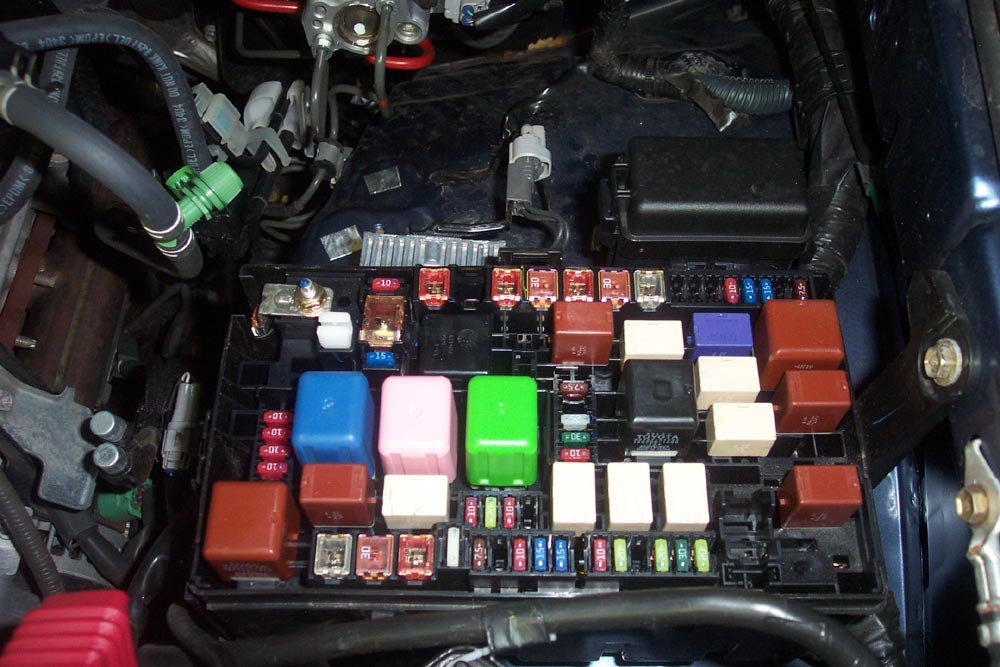

TRAC Mtr Relay perhaps
There is a relay in the Engine Bay relay Box, it is labeled Trac MTR Relay. I wondor if pulling this will shut down TRAC control. It's in the wiring diagrams. It seems there are also relays for VSC , yaw sensors, and Skid control.

Zaraspook, try this if you dare. Pull the pink TRC MTR relay. See if you can burn some rubber. My guess is it won't allow TRAC to be active any longer. Perhaps it will display on the gauge cluster as a VSC failure, amybe even generate an error code? Who knows, but it does control the TRAC system.
