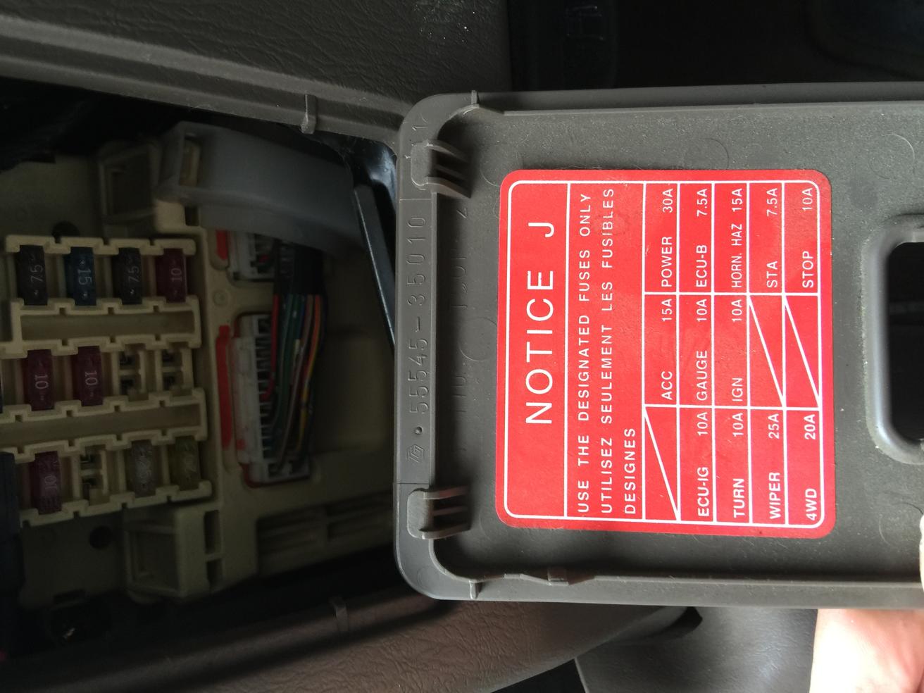

Which fuse is the fuse for the blinkers?...
My hazards work. But no blinkers either side.....
Turn signal fuse is located in the kick panel to the left of the steering wheel..

I just had exact same symptoms and it was the turn signal fuse. Weird that the flashers work, and pushing them in a little allows the blinkers to work. “What blew the fuse” is what I want to know…
If no trailer or trailer 4 pin module connected. I suspect a short occurring on the turn signal circuit.
Any bulbs blow recently and take out the fuse?
