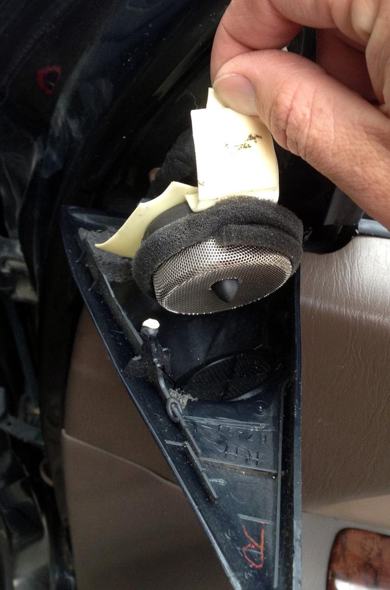

Not that detailed but it's pretty simple once you open it up. Minor cutting with an exacto, plus some 3M mounting tape and you are good to go. These are the factory limited tweeter covers. I don't think all models had them.

Thanks for the picture Brian! You're build thread is making me consider making a stop to Joanne's for some sound deadening fabric.

Btw the tweeter pictured is an Infinity Kappa tweeter and I had to remove the plastic case surrounding the tweeter, peel off the Shell essentially, so that it would fit inside the black plastic factory tweeter cover.
Installers do this all the time since most aftermarket tweeters come these bulks plastic shells.
