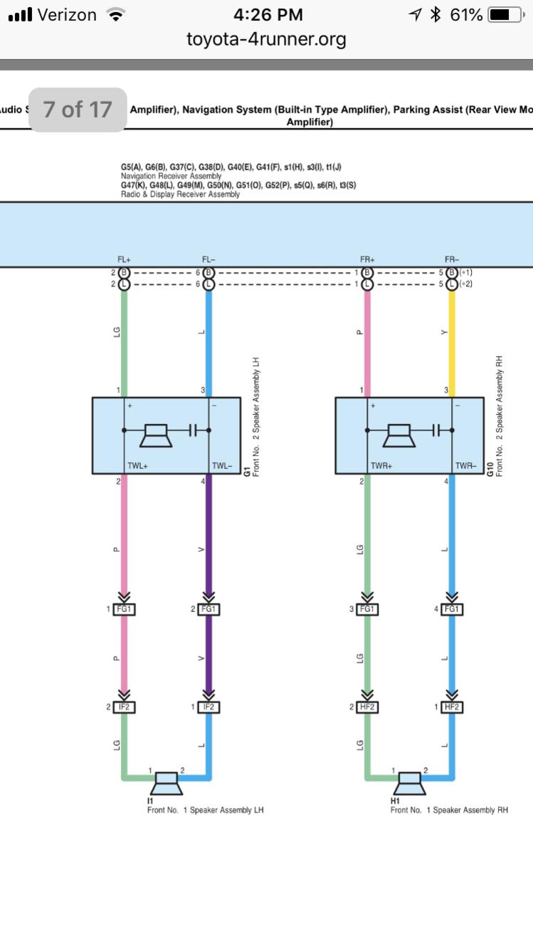

B bkaushansky Member Jul 7, 2018 #1 Looking at the wiring diagram I just found non-JBL with Nav, the filtering capacitor is on the negative arm of the stock tweeter. Right?? Thx. Attachments C9DF0B9B-2A3A-4C2C-8D3C-0A804765CF9F.jpg 59.9 KB · Views: 1,091
axxman Member Jul 7, 2018 #2 Correct, for some reason toyota wires the dash speakers opposite from the rest of the speakers
