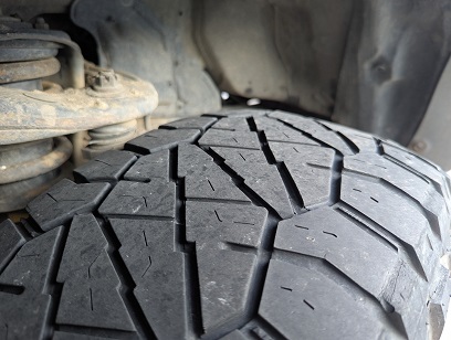

Got some Nitto Ridge Grapplers and loved them for a year, then noticed bad sway bar bushings (frame/inside were loose due to rusted brackets) and bad LBJs. Fixed issues with larger than stock bushings and had a shop do new LBJs but noticed bad outside tire wear up front on both sides.

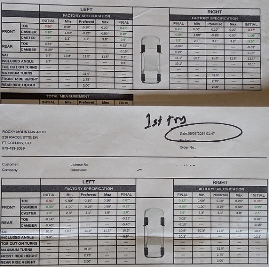

I'd love anyone's advice on what to do mechanically if anything to stop the outside edge wear since the wear seems to have continued after the fixes and even after two alignments. pics below of spec sheets of most recent two by same shop that did LBJs. I've rotated well enough that I'm thinking about having the tires flipped around since they all have outer edge wear.

Pics of alignments and FL tire:
If I were you I would check the toe and camber myself and adjust as necessary.
Download 'Angle Pro" on your phone, or purchase 'Gem Red" level box, it's cheap, to check camber.
Check your toe at wheel center front of tire/rear of tire. I have a couple of 6x6 cut to the height of wheel center line, place one in front of each front tire then measure across from center of tread to center of tread and record. Then put the 6x6 in back of each front tire and do the same. If the difference (toe) is more than 1/16" in or out, adjust it with tie rods to 1/16", or less.
Put a straight edge vertically across your front rim and use angle finder to measure camber. I like them almost vertical, but a degree either way is fine, IMO. If you find that the top of your tires are tilted out a couple of degrees I would have camber adjusted to straighten them out, vertical to 1 degree in at the top.
I have SPC UCA, so I can adjust camber myself. I have Michelin LTX 265/65R17 with 50k miles, they have perfect tread wear. I also run my LCA in the neutral position and locked in that position with cam eliminators.
I found the chunkier the rubber pattern the harder it is to correct wear patterns by driving.
Our solid rear axles can straighten out tire treads.
You might try running the worn front tires on back for as long as necessary. Assuming the current tires can be rotated with ok tread on front.
