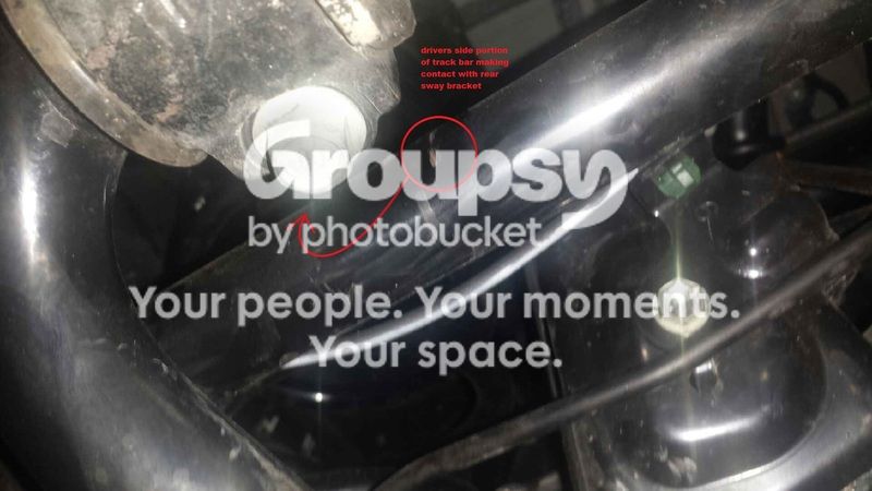

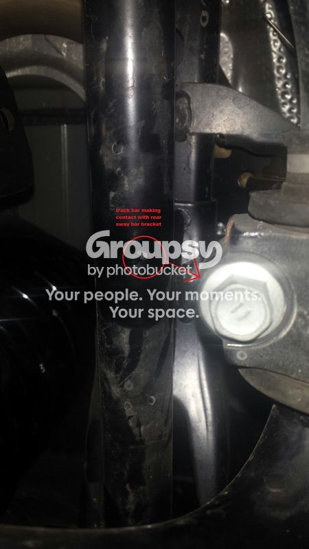

1) Track Bar is making contact with rear sway bar brackets. Making distinct "clacking" sound over sudden bumps.
Doesnt seem like it is damaging anything terribly. Just appears cosmetic. I attached pictures so people who may be experiencing the same issue can verify for themselves. It will appear on the track bar directly in front of the rear sway brackets.
SIDE NOTE: I get a rattling sound when i drive over uneven terrain. I have no idea what it could be. I feel it could be related to this but I have no evidence besides the markings. I dont think such minimal variations could create a sound but it makes me thing something is loose. Checked everything tonight and it appears fine. Have NO IDEA what it could be >:(

Can you get a picture a bit further back, I can' quite visualize where that is exactly on the vehicle.
Also is this a KDSS system? Wasn't there something about there being slightly bent aftermarket pan-hard bars to clear the KDSS system?
Yes. The pictures are the driver and passenger side REAR KDSS sway bar brackets contacting the track bar. I am raising the front end to level the truck a little more so I will take a couple pics while I have it raised up.
