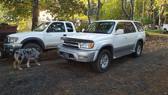

We moved to Oregon from Michigan in October of 2015, and man are the cars CLEAN out here. I knew I wanted a 3rd gen, and realized I would like some leather, so a limited was in my future. This 2000 with 155k came up for grabs in the town 10 miles from us, along with a 1998 with 150k, both super clean, but it was obvious the 2000 was what I wanted. We finally settled on a price and she became mine towards the end of October. I bought it from a girl in her mid 20's who bought it from her aunt and uncle who had it since new. It was bone stock and had clearly never been wheeled....I spent the first couple weeks shifting into 4wd to get the actuator freed up, and now it shifts in like it should.

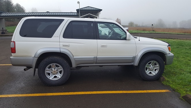

The running boards came off within days, and it really cleaned it up. Having had the Tacoma...the 4runner's running boards were simply awkward. They didn't work height wise for me, and made you step further out to avoid getting junk on your pants.
I threw in weather techs all the way around, replaced the rear gate lift struts with some Monroe's, put AVS rain vents (it rains a lot in OR and my dog fogs the truck up), ordered some replacement FOBS off of Amazon for $25 and got them programmed in. Ordered a Koyo radiator and had that thrown in.

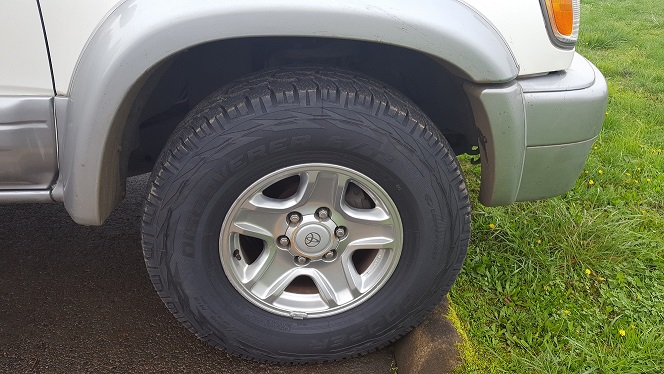

The truck ran so nice, aside from a pull to the right. I put some Cooper AT3's on it, 265/75/16's, 6 ply. I have 10 ply duratracs on my Tacoma and am happy with the 6 ply of the AT3. They don't look nearly as aggressive as the duratracs, but do have a little better road manners, and they do have a nice lug to them. The rig will be 90% on pavement and nice gravel roads, so I went more conservative than I did on the truck. New tires and an alignment and she rolls nicely down the road.

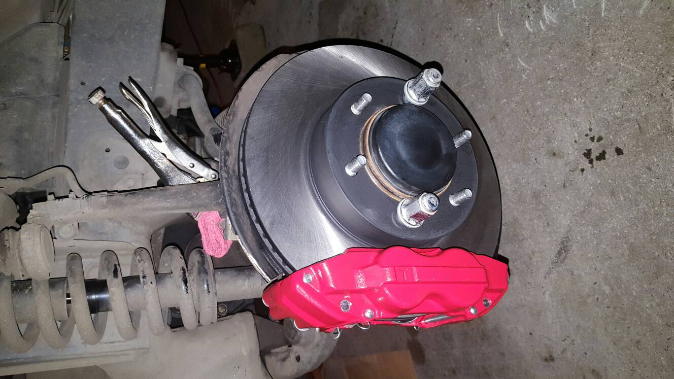

Going junk yarding this weekend. Will be searching out a hitch, roof rack, and alloy rim for the spare since....Tundra Brake Upgrade parts are on the way.
I got Power Stop S2712 Calipers for $229 shipped...$80 of that is core charge, $30 for shipping. These are S13WL remans, 231mm.
Rotors and pads from camelback for pads - $64, rotors - $128, and shipping of $22.
Another buddy in town has a 97 and learned about the upgrade from me, got really excited, and ordered all the parts. So we will be having an early Christmas brake install in a few weekends.
Not sure how good I will be at keeping this up but I did the TBU 231mm upgrade two weeks ago. Still need to do a second round of bedding to get rid of pedal travel. Overall the brakes grab great but requires further push to engage. On ice the ABS triggers pretty quickly but still works as ABS should.

I should have stated above that even had I not done the TBU...the truck was due for new calipers as both sides had a side that was seizing. So the upgrade was great as it got rid of my pull to the right while braking as well as the slight shutter I had while braking and turning at speed.
