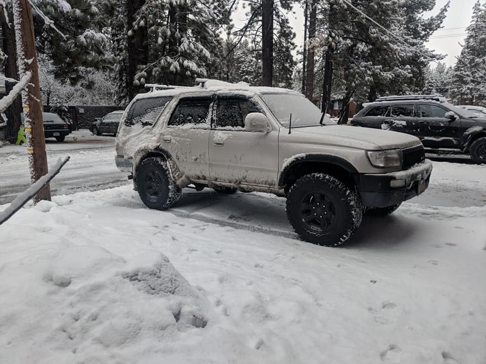

It's been a while but I recently started putting work in the 97 SR5. Picked up a set of K02's and they are amazing to say the least. Took it up to Tahoe over the holiday weekend and ended up pulling some kids out of a snow bank. They went skiing with no chains!
