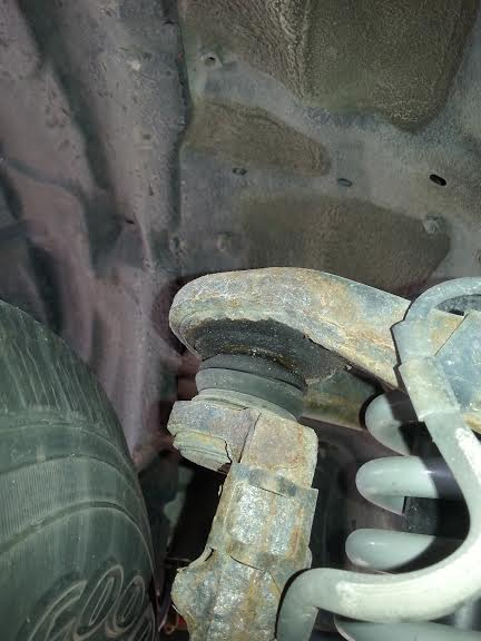

Hey, folks - Wife tells me she's getting some clinking and clunking occasionally in the front end at slow speeds going over bumps or turning. Checked everything out underneath there and this is the only thing I could find upon visual inspection. Everything else has been replaced on the steering and suspension and is solid. What do ya'll think? (I don't believe it matters, but this is an '01)

Did you jack up the front and rock the tires, at 6 and 12 and then 3 and 9? Because just looking often won't tell you much.

Nope. Haven't had time to yet. I can maybe get to physical testing later this week. Do you think it's a major concern or something that can wait a week or two based on the pic alone? Never dealt with UBJ's before.

Anttging suspension related is prett inportant. I would check it right away and replaced if needed..

Pretty much. If there is play at 6 and 12, that UBJ is a serious concern. 3 and 9, look elsewhere. Also check all four hubs for excessive heat after a drive (don't burn your hand). Might be a wheel bearing.

A buddy of mine also mentioned wheel bearing as well. That would certainly not make me happy. Gonna get it all checked out within the next few days. Thanks, guys
