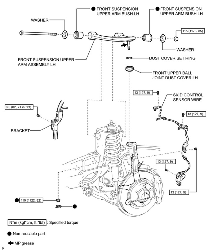

Not sure on factory UCAs but Total Chaos recommends 85 ft/lbs on theirs. I do not use thread lock as I loosen them to grease my bushings. Ive never had a problem with them coming loose at that torque. In fact, it takes a breaker bar and a good amount of force to crack those suckers loose.

Yup 85
