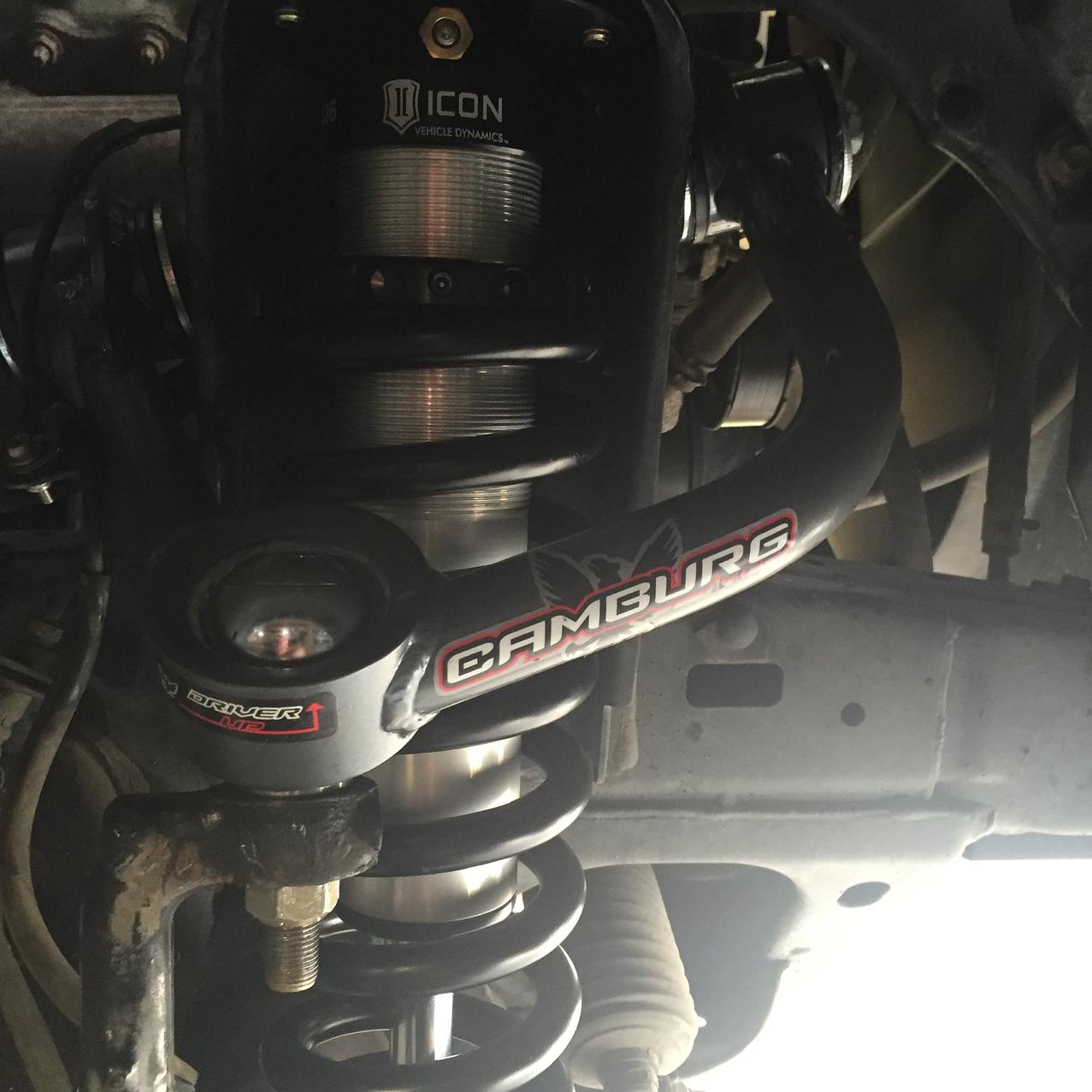

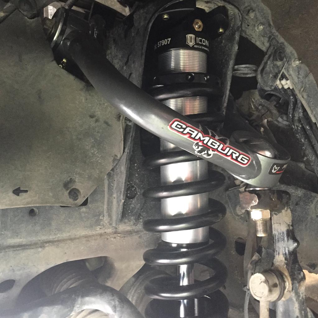

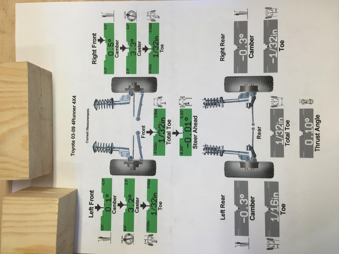

So...instead of just typing a response, I figured I'd show some "data". Please see the photos showing the installed upper control arms and the alignment specs achieved with the shown setup. A few things to note:

Front setup:
Icon Extended Travel 2.5 coilovers, installed at shipped height from Icon
Camburg Upper control arms, 1.25 inch uniball
2. You sharp-eyed folks will notice that the camburg labels for Driver and Passenger UCA's are ON THE WRONG UPPER CONTROL ARM. Pretty disappointed by the lack of attention on that one. Also, the instructions are absolute garbage. Download Icon's upper control arm instructions, then watch the Total Chaos Youtube video if you're looking to install these on a 4Runner. YOU DO NOT HAVE TO CUT ANYTHING ON YOUR RIG, AS CAMBURG ASSERTS. You also don't have to bend a damn things out of the way as the other guys assert either. Undo a few bolts and you're good. Be creative. Also, you'll get Standard and Metric hardware with Camburg's Upper Control Arms. Cuss and swear at them like I did, then move on...

And before anyone gets upset, note that all of those components are the same for my rig and the 5th gen, EXCEPT for the sway bar relocation bracket for the 5th gen vs. the 4th gen. That is the only difference. Just thought I'd help you out with the questions.
