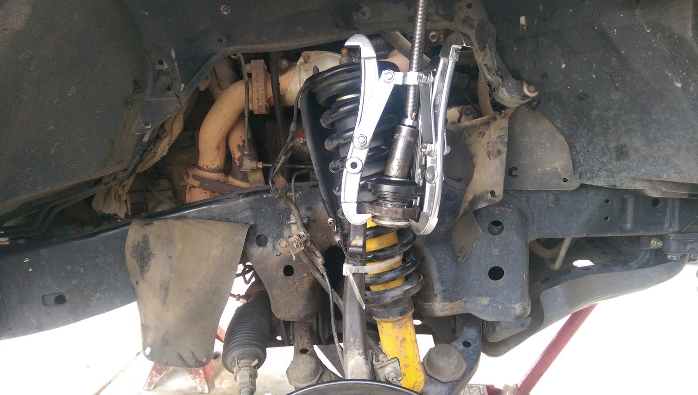

I cut the top off the ball with a Dremel tool (and hacksaw when that broke), and then used a large socket on the top to press it out with the 3 jaw puller. I put a bolt in the top of the socket to give the puller screw something to set on.
Soak it with penetrating oil, and then put some pressure on it with the puller and hit it around the edges with a hammer. Give the top of the puller a smack too if you can get on it. Then tighten it some more. Mine were tight, but they came out using a puller just like the one you have.

Run down to your local autoparts store and rent ya one of these guys, ball joint press....
I usually cut stud off even with the top of the ball part of the joint also, just to make it easier to deal with the tool.
Take a dremel and cut this off:
Then get a socket (I used a 27mm because it fit perfect) and the ball joint seperator with the 4wd adaptor kit from O'Reilly. They'll charge you a deposit (~$200), but you'll get it back when you return it. Set it up like this then...
It's a tight fit, but I didn't have to take my spindle off the LBJ to do this.
Harbor Freight is going to refund me for the one I bought too. That damn thing looks like it's been bought and returned AT LEAST half a dozen times. It's beat to hell. :boxer:
If you use a socket you don't have to cut it. Here was my install.
