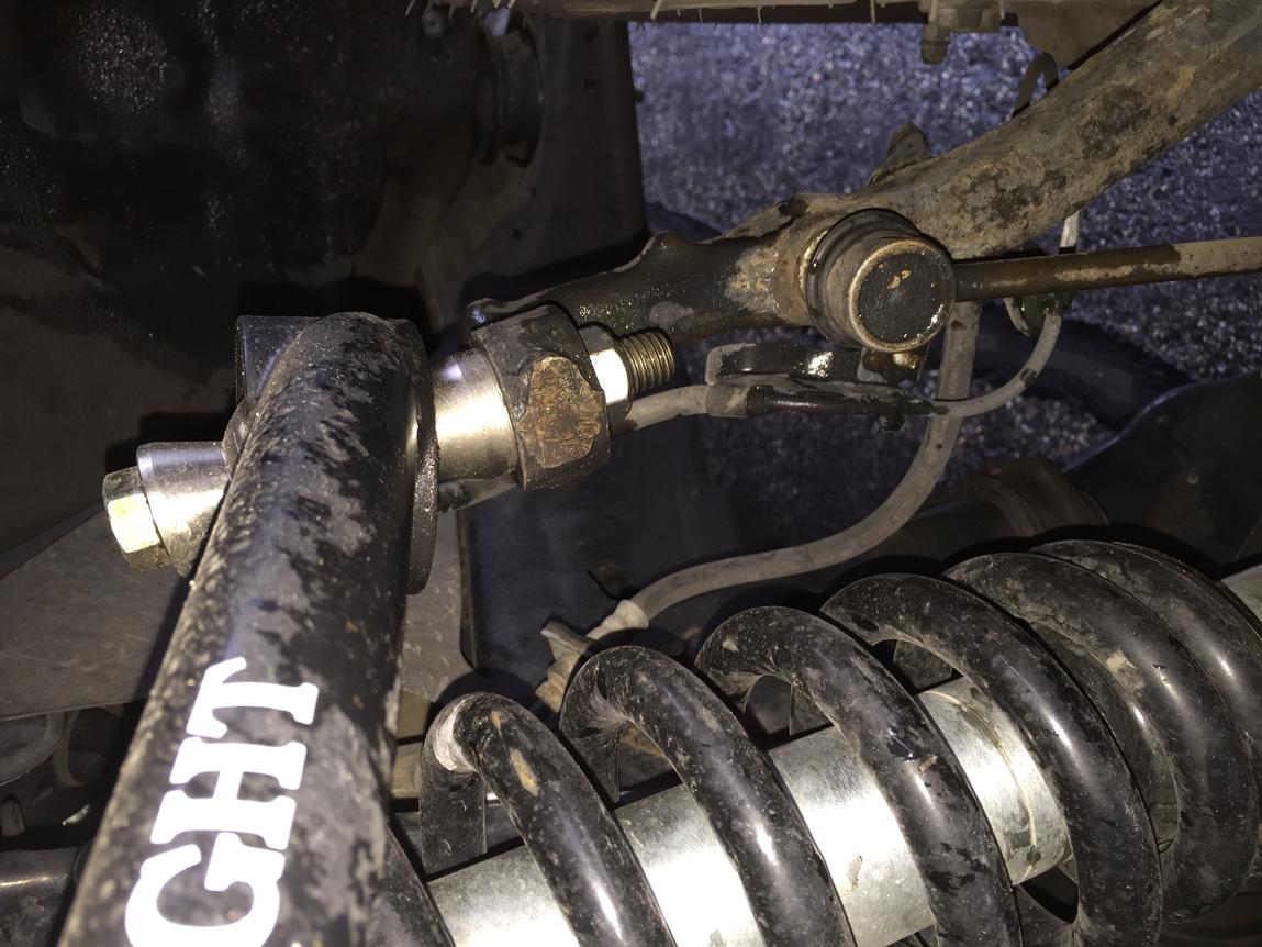

It seems pretty close to topping out.
When I lift the front off of the ground I cannot rotate the front tires more than a 1/4 turn. I think Cardone CV's are causing this but it drives fine on the road.

That definitely looks topped out if not damn near. I'd lower your front end a bit to get it to be somewhat centered.

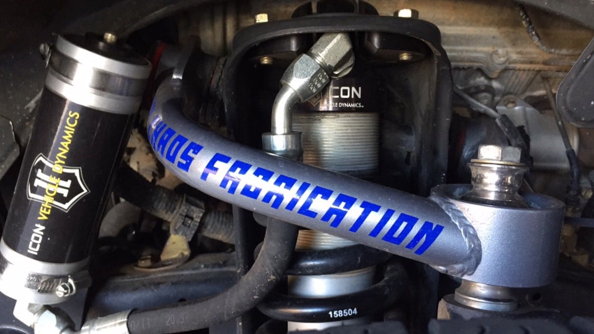

Here are mine at ride height for reference
Yeah I might have to lower my front. I have the 885 with top plate setup which many people have. Not sure why I am having trouble.
