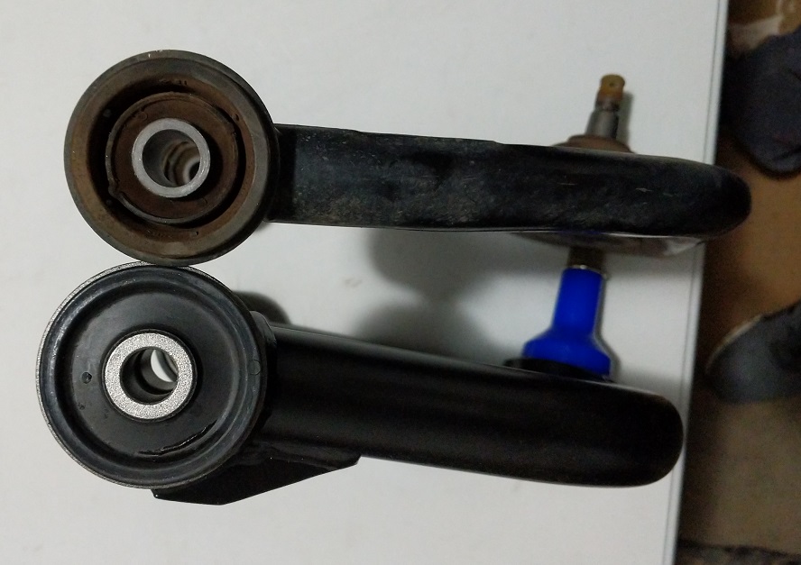

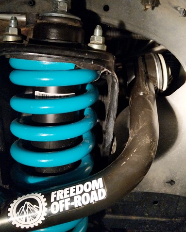

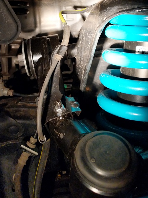

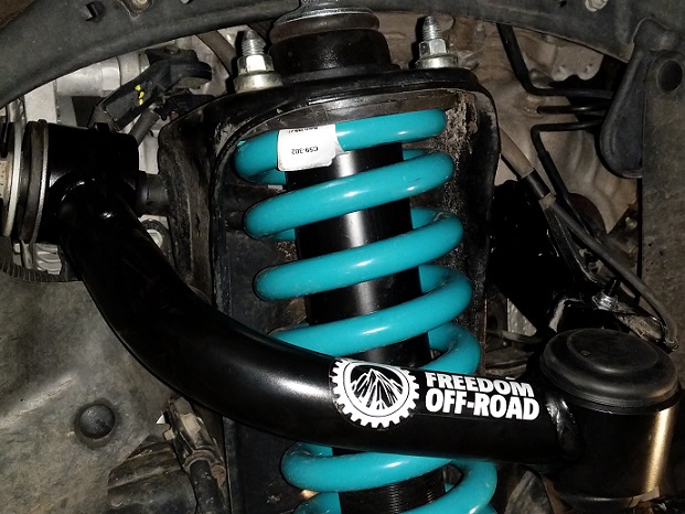

I'll go against the crowd here - I couldn't justify the $500+ for SPC's. I figured why not try the Freedom Offroads, worst case is I sell them and a take a slight loss.
I've had them on for a few hundred miles now and my initial review is I'm impressed. The alignment I got pulled a 3.6 caster (all other specs in the green) on a 2.5" (sitting closer to 2.7") lift.
No noise, build quality and fit are great, just seems to always be get the most expensive item or it's junk.
Long term, we'll see how the ball joints hold up. OEM style bushings are a big plus in my book, and grease-able OEM style ball joints are a second plus. You can get replacement ball joints for under $40 a side, so not bad if they did need replacement.
YMMV - be a bit different than the masses. These things have great reviews on Tacoma World - that was the real selling feature for me.
