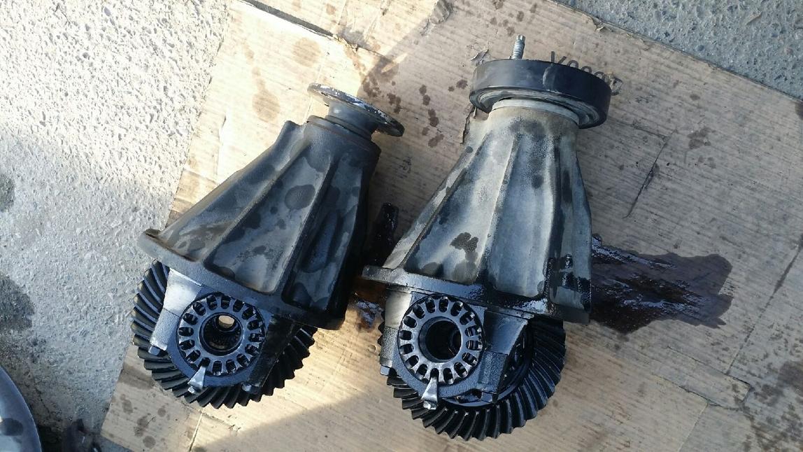

so theres been a whining sound coming from the rear of my 4runner. at first i though it was my rear wheel bearings. Took it to a friend since i dont have the space to work on my car. he worked on it and come to find out it was my 3rd member. I set out on a mission to go find a used one at the salvage yards and finally did. I brought it home today and found out the flange is totally different.
So my question is will this fit or do i need to go return it?
i have an 2006 v6 4runner sport edition 2wd. the 3rd member that i got from the yard was from a 4th gen. I was there and watch them pulling it off.
heres a pic. the one on the right came off my ride.

Today is your lucky day my friend. I swapped my 3rd member for one from ECGS but I ordered one with a "harmonic flange" by accident. It bolted right in no issues there, the bolts I think thread into the flange instead of clamping it with nuts from what I remember. I emailed ECGS about this and they said the harmonic style flange was apparently used on 2wd 4Runners evidently they had a driveline vibration. They said as long as it bolts in it should be fine. I've run mine for a couple thousand miles no issues other than boulders scraping the flange when rock crawling.
Ah, but you are swapping from a 2wd flange to a 4wd flange...
You could get a driveline vibration then.
ah, ok i see now. yes mine is a 2wd and the other came off a 4wd. looks like i might need to drive back 3hrs to return it. I specifically asked if the 4wd was the same as the 2wd and they said yes.

I do not understand the problem. Why can't you simply take the flange you want and put it on the new 3rd member? I do it all the time. Just make sure that the nut is staked and you have similar bearing preload and you will be fine.
I was thinking the same, but i already returned the new one, so no go on that. plus for an extra $100+ i can have a new rebuilt one. so i just went with that option.
