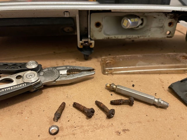

Just tackled this job today.
10 year old LED bulbs have been flickering for a few months.
Found 4 completely rusted out, disintegrating screws.
I took the whole bezel off to make the job easier.
Sprayed seafoam deep creep all over both ends. Gave it an hour to soak.
Tried the dremel cut method first, didn't work as there wasn't enough solid material left in the screw heads to use flathead on it. Just kept turning.
Eventually 3 came out with an extractor, the other had to drill the head off and twisted it out with pliers from the other side.
New stainless screws are in now.
Just a word of caution , if you take off the bezel don't close the tailgate like I did. Brain farted and then I realized the switch is in the bezel. Had to go through the trunk to release the gate :nerd: put a piece of wood over the latch so it doesn't lock.
Good times :cheers:
