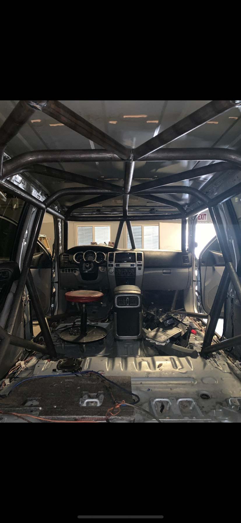

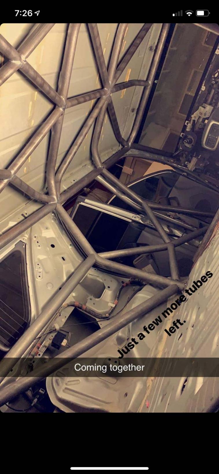

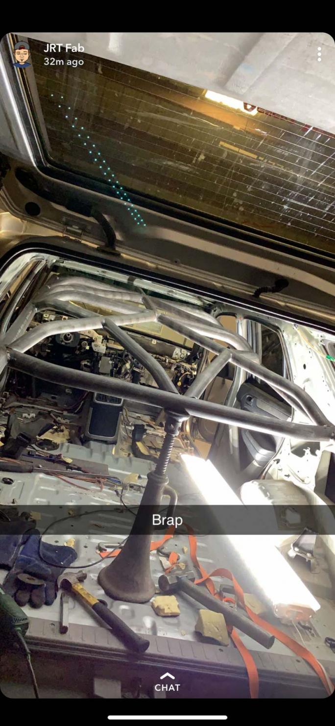

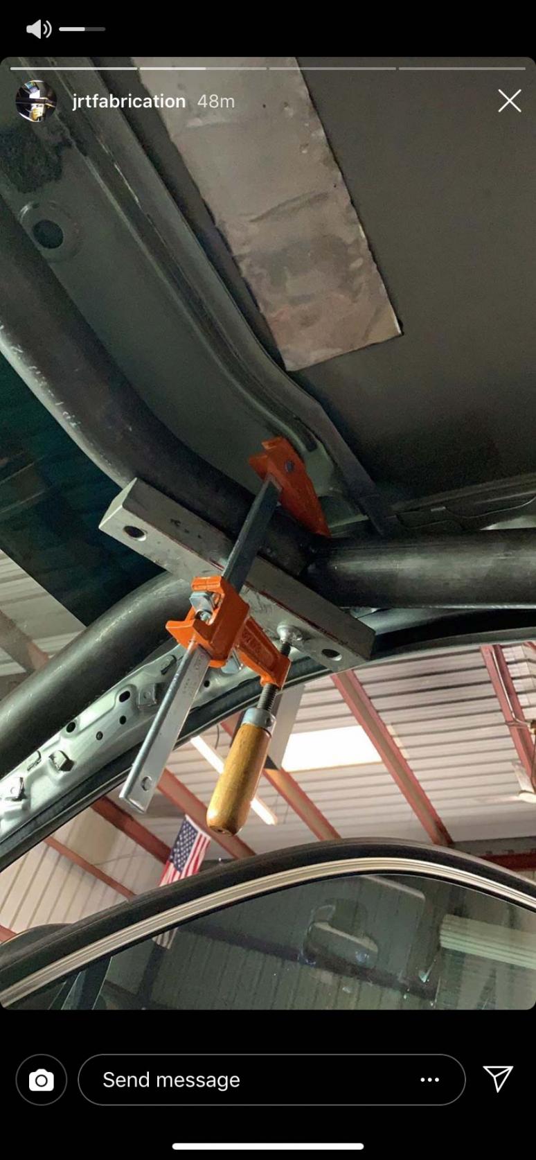

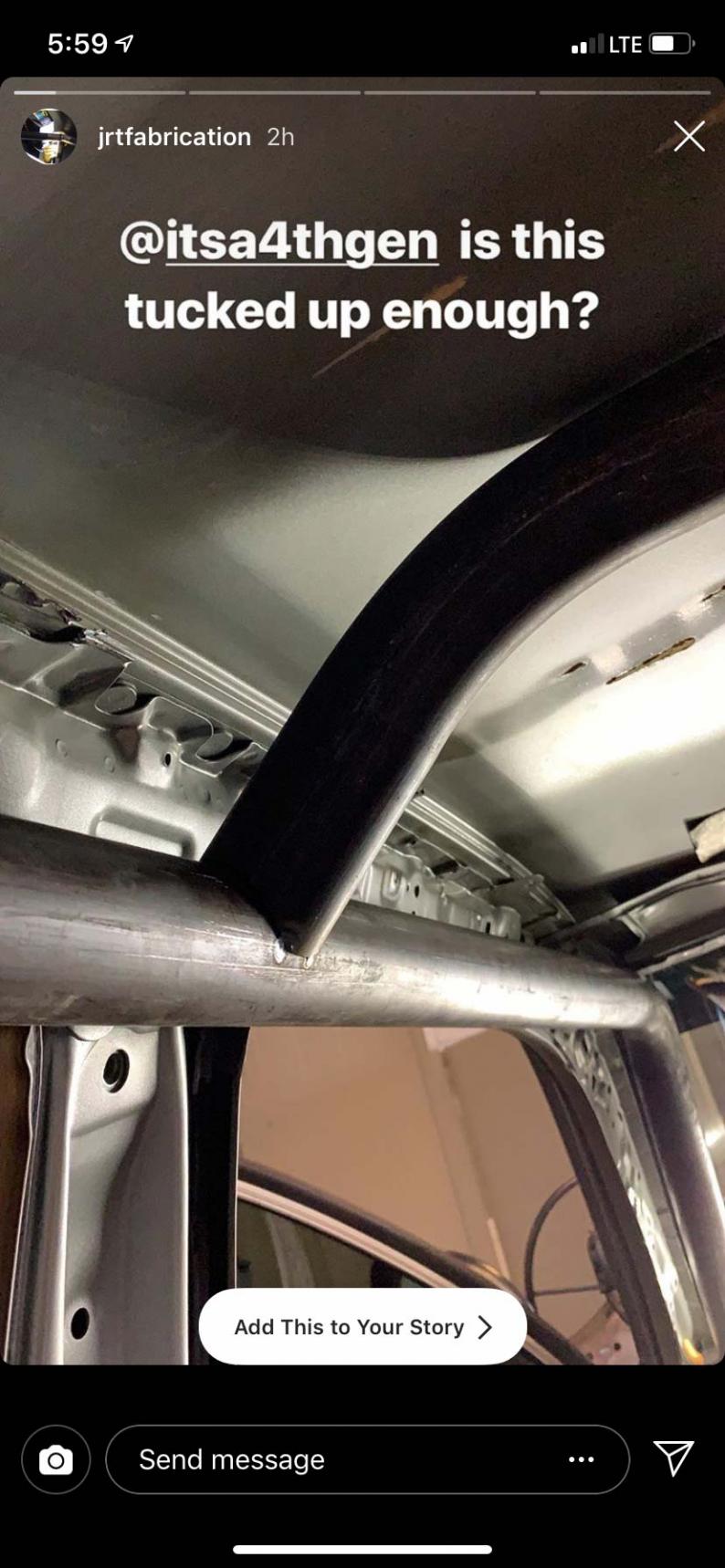

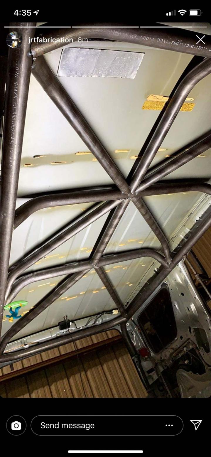

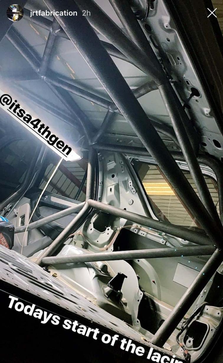

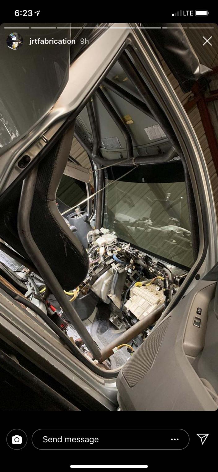

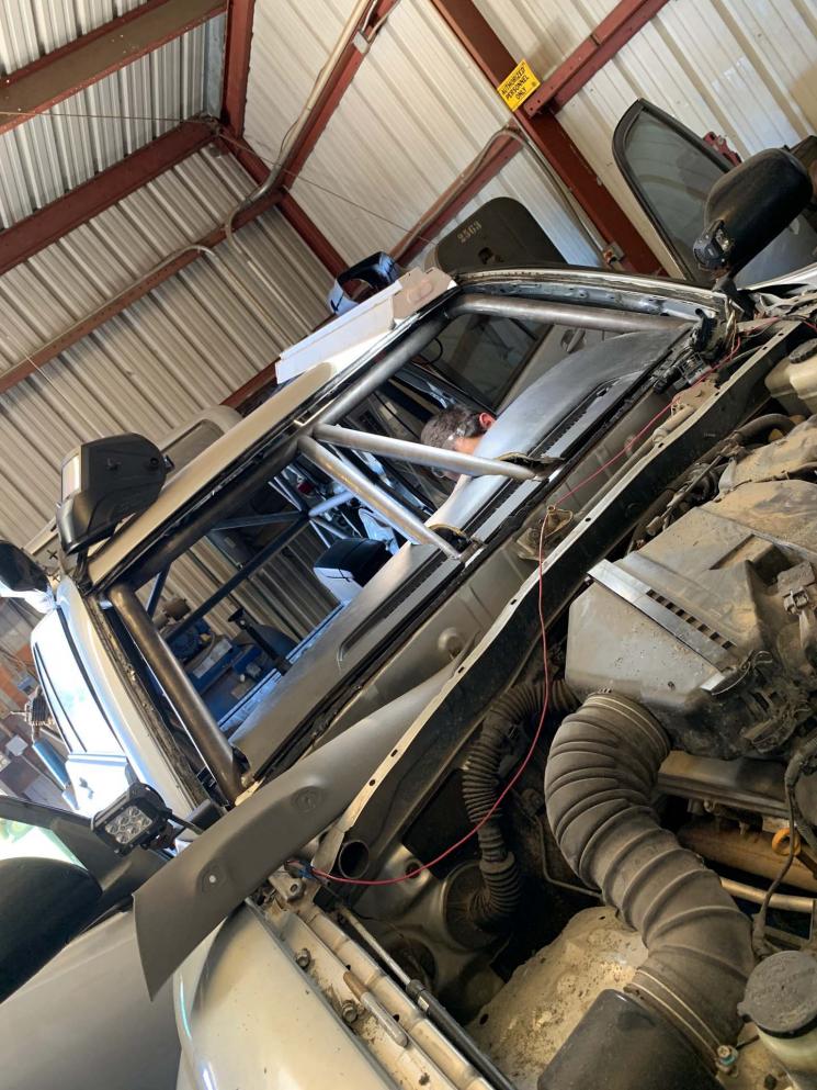

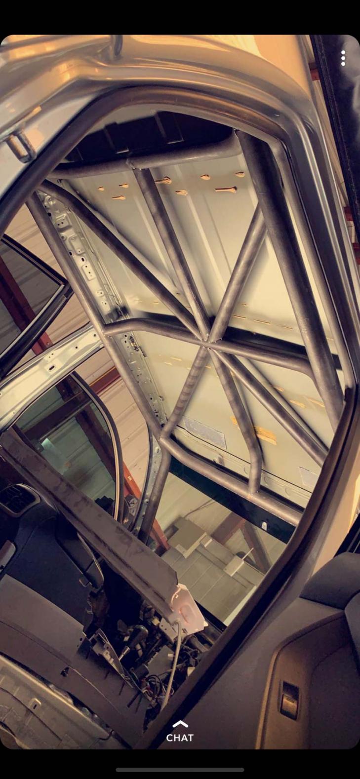

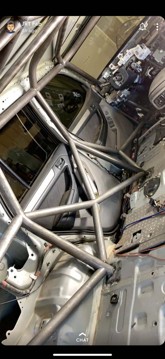

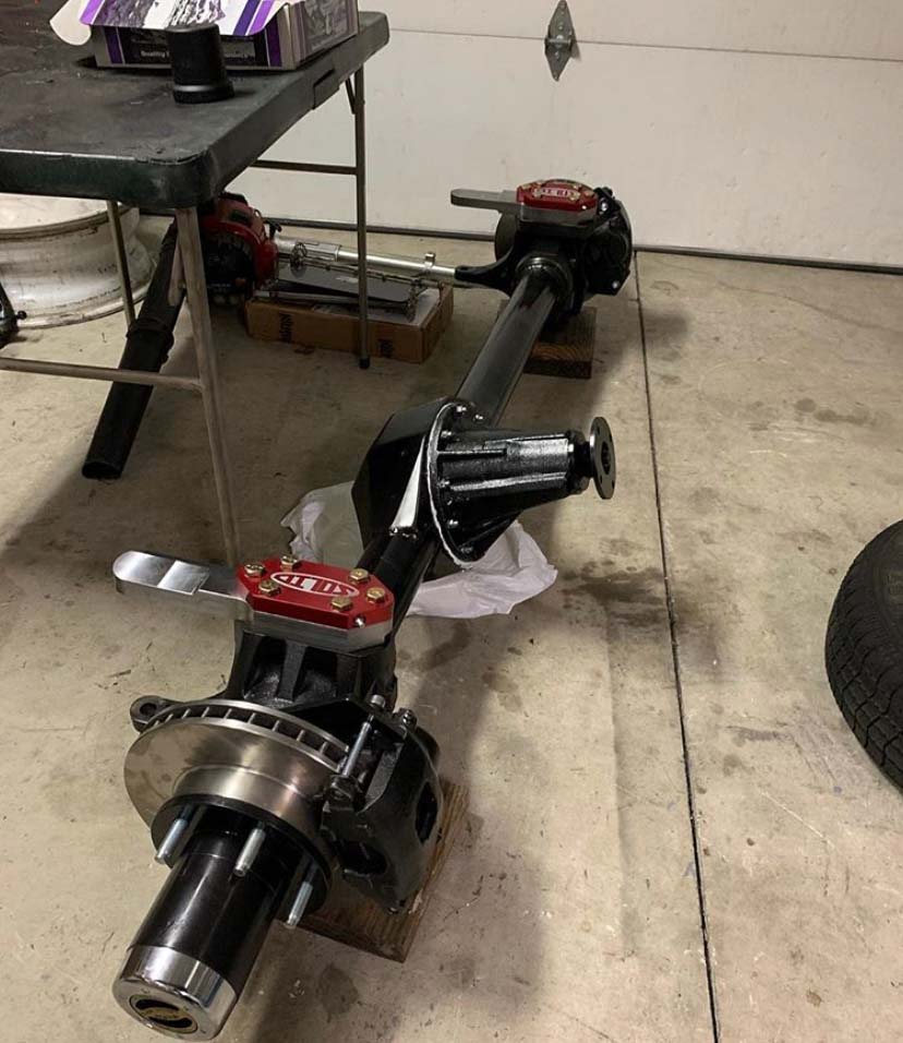

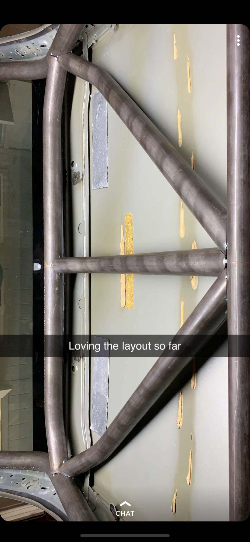

i still need to find pics of my rear axle swap lol. but here are all the pics of the roll cage being built and completed and a pic of the front axle i went with

Nice build, a crawler I would assume since you added the roll cage.
I would assume a roll cage is more for high-speed trucks. With crawling you either just flop over or roll a couple times down a hill before a tree stops you whereas with racing you have a tendency to run into things or roll a half-dozen times at 50mph when you wreck.
Loving the tube work. Are you doing it all yourself?
thanks. Im not doing the tube work, im having my buddy who is a fabricator build it. Rather have a cage I know i can trust with my life lol. But its all DOM and TIG welded race legal cage with 2" mains and 1.75" lacing.
So no door bars are required??
To race i will have to raise the front door bars. but i have door bars right now. Just have them low to clear the seats. Ill have to do custom door panels to get them up higher for Race specs.
I stand semi corrected. My buddy Lance used to race but after a bad crash he rebuilt and never returned to racing, today the truck just sits. I think he might have a build thread on t4r.
