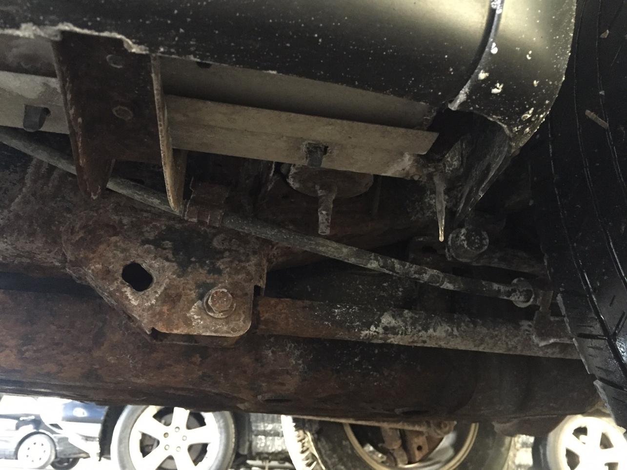

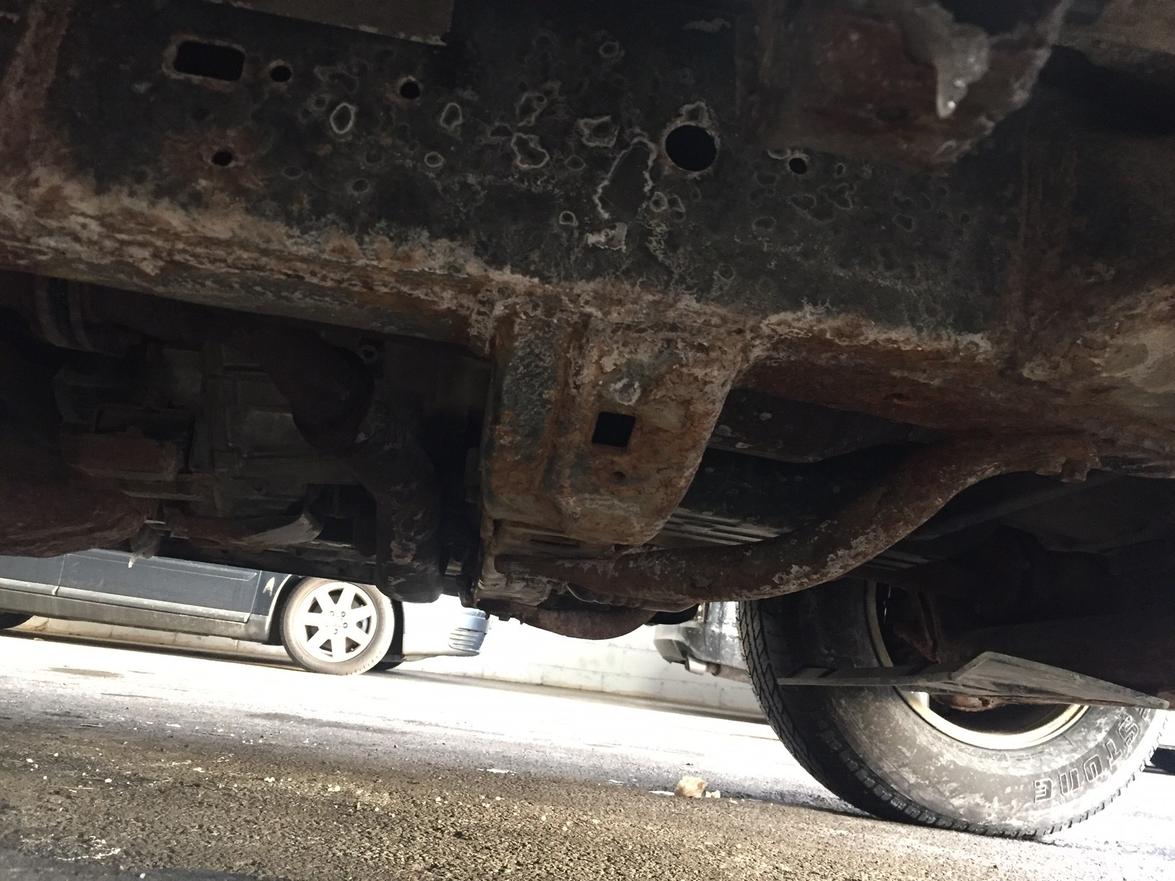

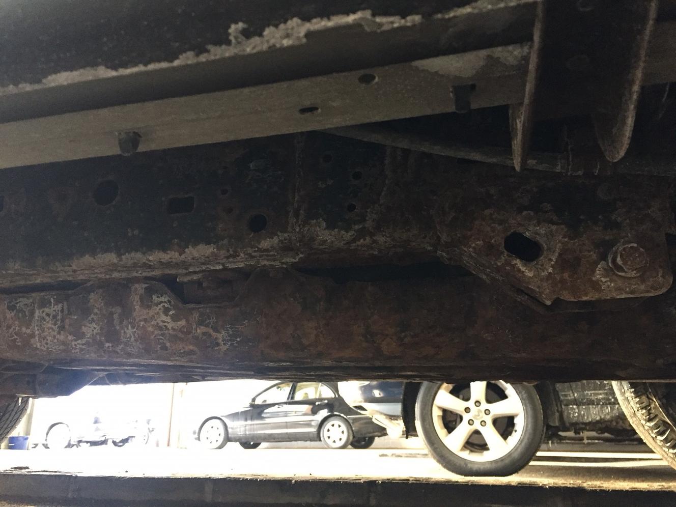

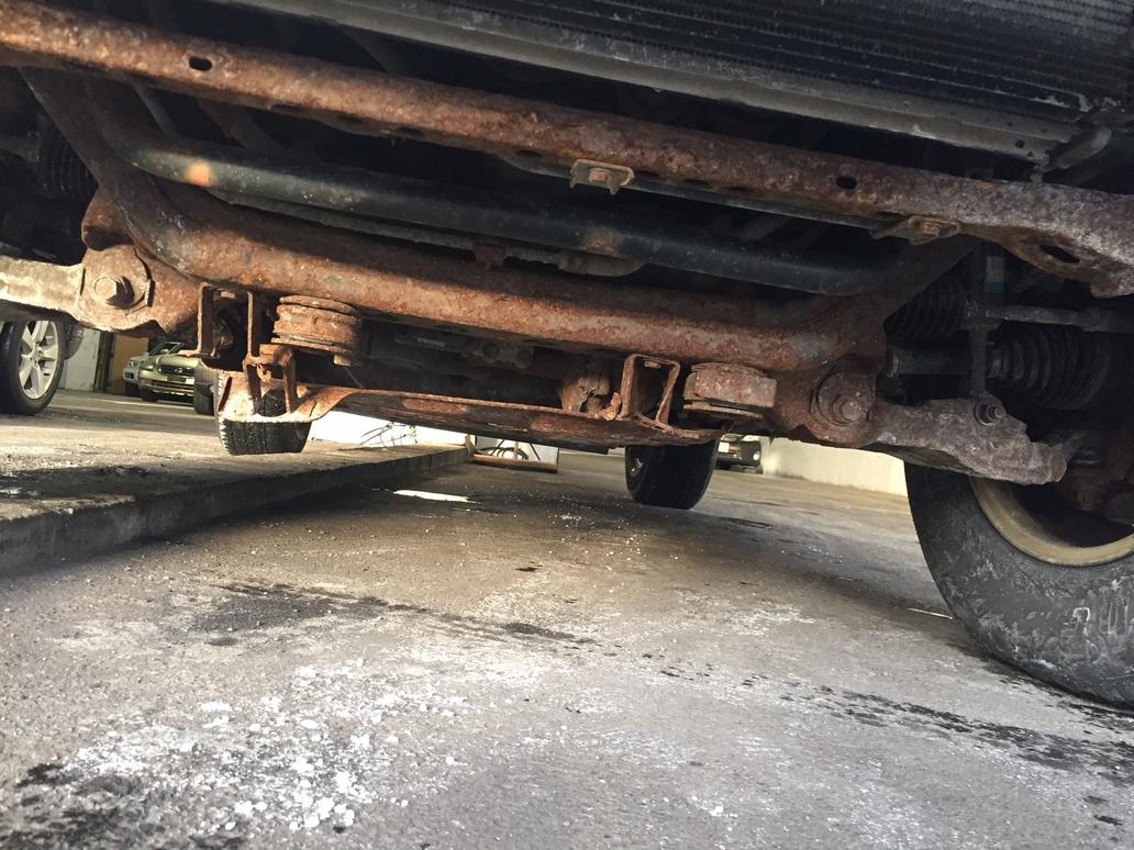

I am considering an used 2004 4Runner but the under carriage rust is preventing me from pulling the trigger. What do you guys think? Is it mostly surface rust? Also, are there any plastic covers protecting the under carriage? All the Lexus vehicles I owned had the under carriage covers.

2 things.
1) start your own thread instead of bumping this old one.
2) Everyone has their opinion, but in my opinion I would walk away from that runner.

X2.....I would walk and try to focus my search in a state/area where road salt is not used. You'll incur some travel expenses, but you'll end up with a minimal rust vehicle that will be easier to work on and have better resale down the road.
Thanks for your replies, I am already looking for other 4Runners but here in Northeast, almost all 4Runners have under carriage rusts.

You could use a rust converter to help control what you have if it's only surface rust.
But the frames on these rust from the inside out so you don't see how bad it is until it's really bad.
I had to put another frame under my 83 because it was so bad I couldn't patch it anymore.
Both my 4runners came from PA, and the frames were solid.
That's why I bought them.
Toyota frames SUCK.
