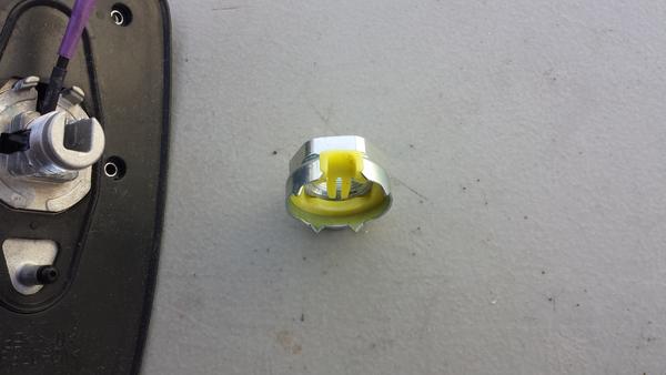

Getting ready to install a rack which will interfere with my sharkfin satellite antenna. I don't care for XM, so I was willing to live without it in order to have a full length rack floor.
So I removed the sharkfin. And I was disappointed to see what was inside.
No need for such a tall assembly. It could have been 1/2" tall.

Interesting photos (albeit, a bit too tiny for me to see well), but there's something missing from your antenna that mine had!
You see, there's a short fin-like antenna that mine had mounted to the pc board, it looked like either an FM-diversity antenna, or perhaps the antenna for remote start.
In any case, my SR5 had the non-entune radio and the triple coax plug under the headliner only had one connecter installed, so neither of the two antennas were connected to the system.
Anyways, the reason why the housing is so tall is because that diversity antenna fits all the way to the top of the fin.
