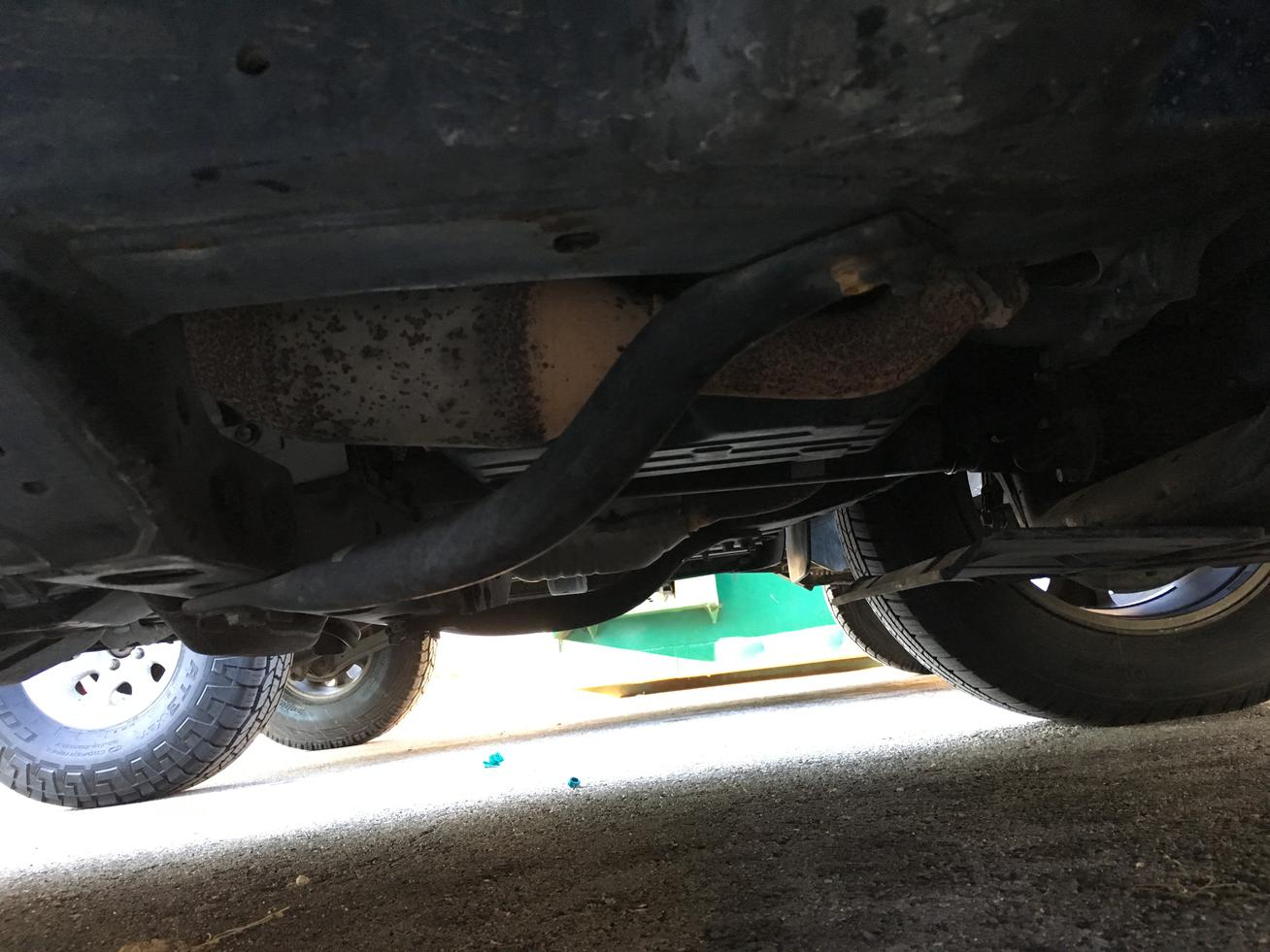

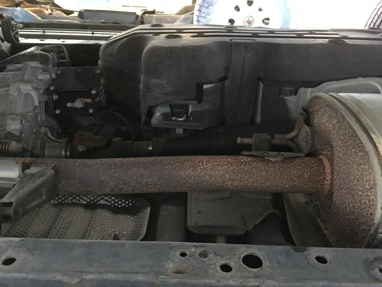

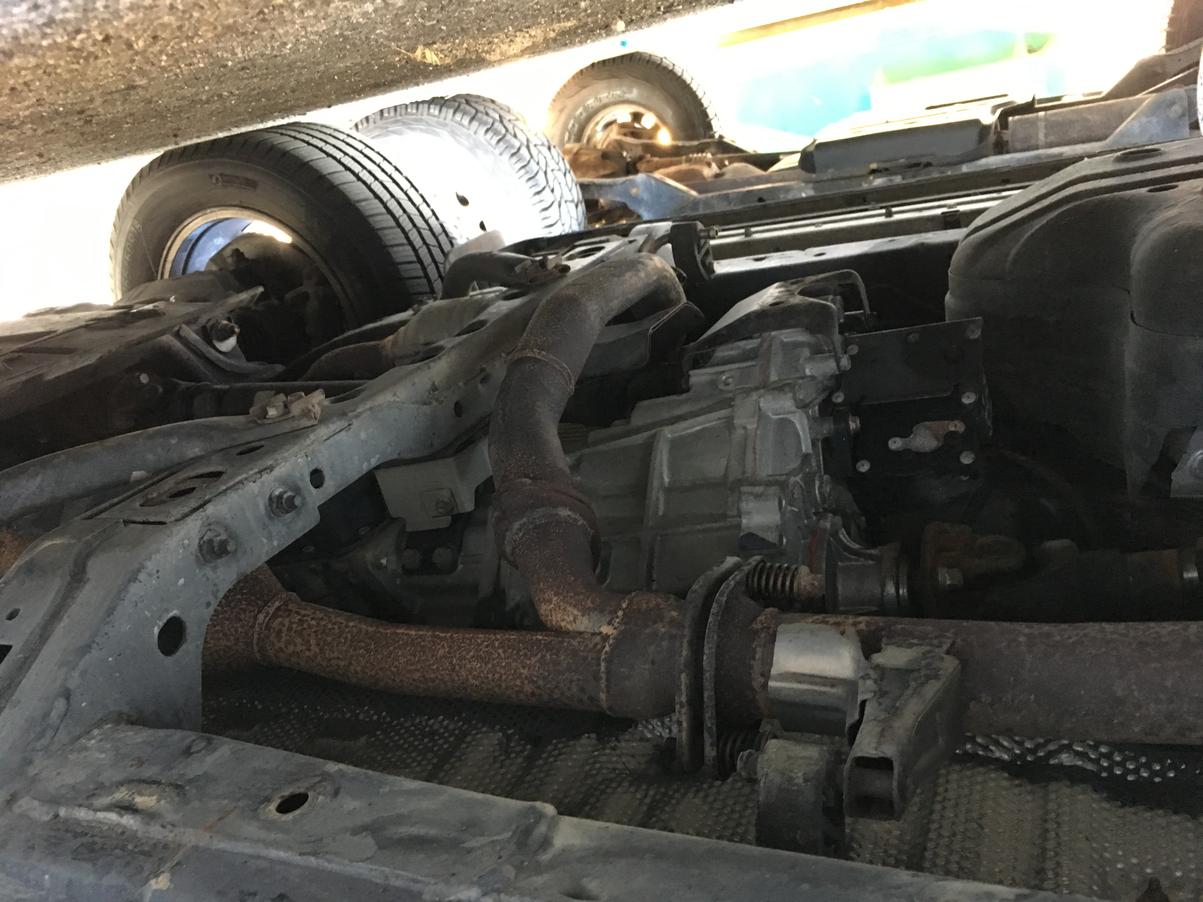

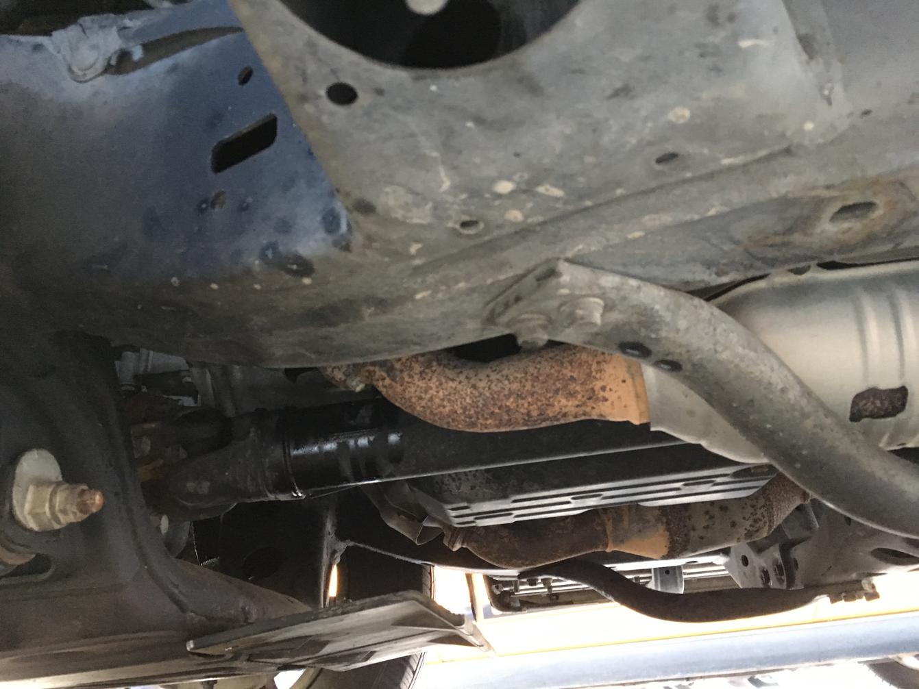

what do yall think about the rust condition of this 4runner?
It’s an 07’ v8 4wd at 182k. Im a total noob with cars so I dont know what anti-rust product i should get, there are so many! Appreciate yall’s help

That looks fantastic underneath! Where are you located? If it's someplace where you need to worry about rust, I'd research your rust preventative options (NOT a rubberized undercoating!), from what I've seen on here Fluid Film is a fantastic product, but you have to be extremely thorough when you apply it.

The frame looks to be in excellant condition, I don't think it need much done to it at all except preventive maintenance, the only rust I see is on the exhaust, which is normal but may need attention at some point if you see any major rusted out areas other than surface rust on the exhaust.
The only concern I do see is the fluid leak on the front drive shaft and where it would be coming from, could be a big issue or not depending on what's leaking.
I'd call that a pristine frame. Tank skid looks great and so do the dimpled aluminum heat shields. As gold seeker said, find the source of that leak on the drive shaft....
Excellent condition. Get it sprayed just the same.
Nothing wrong with preventative maintenance.
I'm in the rust belt and get it sprayed with Krown every year.

I'm based in San Antonio, tho this was bought further closer to the coast in Victoria, TX. Am I right to assume that all those reddish patches are some form of rust? If so do I apply anti-rust on those parts inly or do I apply everywhere underneath that is metal? Thanks for answering to noob questions.
Would the procedure be different for the rusted exhaust compared to other unrusted areas? I was looking at Por-15 Stop Rust kit ( https://www.por15.com/Stop-Rust-Kit )and their Rust Remover ( https://www.por15.com/POR-15-Rust-Remover ) and Im contemplating if I should get both, since rust remover sounds like it's function is to remove, while the stop rust kit is to prevent rust once cleared. Please help me with easy lingo
like it's function is to remove, while the stop rust kit is to prevent rust once cleared. Please help me with easy lingo ��
There's nothing you can put on the exhaust that won't burn off, this is why the exhaust is rusted to begin with, all exhaust on any vehilce
no matter what location you live in will rust except stainless steel and even it will rust a little bit after some time, but if it's still solid I don't
see where it will be an issue for quite a while.
You mentioned/asked above about "little red spots" the only spots I see on your frame is spots from mud or dirty water drying on it, as I
mentioned your frame look to be in excellant condition, I can't see any rust on the frame anywhere in your photos not even any minor
surface rust, if you do have any rust one of the first places affected is usually the radiator crossmember that has the tiedown/recovery loops
on it, if it looks like the rest of the frame you have no rust on your frame, IMHO!!
That being said I see no reason for you to have to remove any rust since I don't see any, a good preventative is all you need, just follow any
instructions that comes with the preventative on basic surface cleaning of dirt, etc. before applying it.

Thank you for your advice. The red patches Im referring to is all the stuff that's on the exhaust. So now I have more questions lol
1. how do I do to preventative stuff?
2. What do I need, and where do I apply them and how?
3.Do I do the preventative on both frame+ exhaust?
4. Also, where's the radiator crossmember?
5. You also mentioned some leakage on the front drive shaft, can you list out some potential issues underlying it? Much appreciated
Is Krown all I need? What do you think about por15 rust stop kit? Are they the same thing or different? As far as applying Krown, is it as simple as spraying and letting it dry or are there more to it such as cleaning before and topcoating after? Thanks for dealing with a car noob
