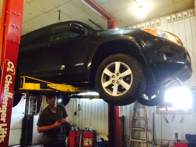

arehman11 - I have my vehicles properly undercoated, with a wax-oil product...every fall.
- and I don't ever drive them through a winter car wash ... I avoid it, for a reason
Southern Ontario uses tons of road salt & liquid calcium in winter...to melt road ice.
- local car washes don't use clean-fresh water
- the recycled water is full of a high solution of liquid salt
- from all the slush melted off the other previous vehicles, to go through the auto wash
- and this can accelerate rust IMO
This approach has work very well for me, in a severe rust belt climate.
- I kept the body mint on a used '88 Pathfinder once, for 14 years of ownership...only oil spray undercoating
