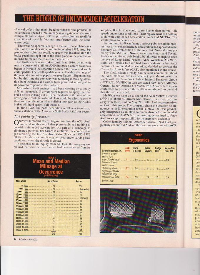

scans now added
February 1988 Road & Track issue :"Solved: The Riddle of Runaway Audis"
Floormat recall was voluntary by Audi in April of 82.(page 54) Sept of 83 they added a spacer to raise the brake pedal to a level higher than the plane of the accelerator pedal. Both of these affected vehicles would have been the early 5000s-essentially the 4000 series vehicle body style with a larger engine.
Here are a few of the scans (1-4) and I will do the rest in next reply.
Same pattern if you see my inference-it starts with the floormats...agreed in that not one single vehicle was found to have brakes not capable of stopping the acceleration.
