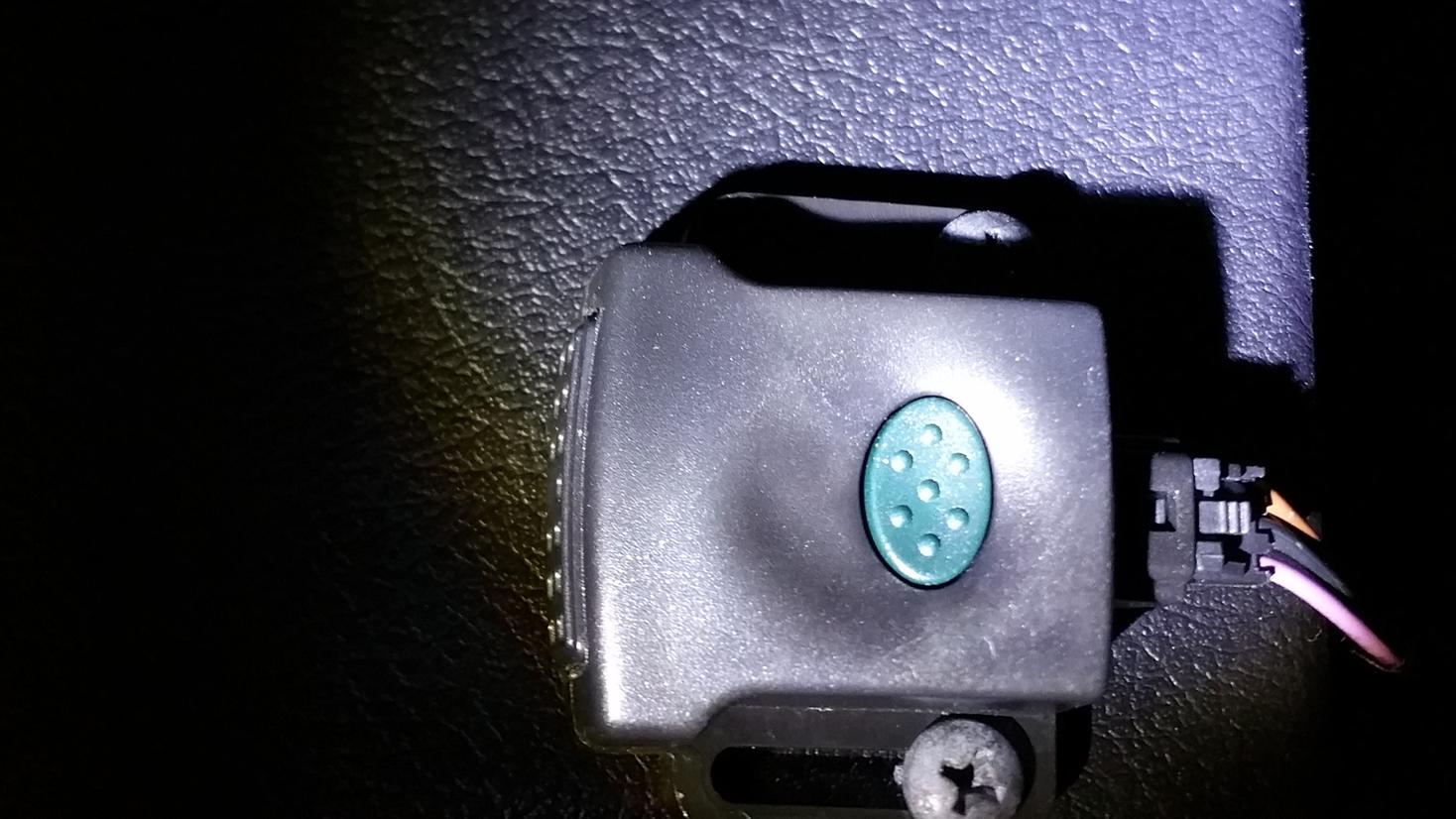

So I am losing it over this button on my console on the lower left driver's side next to the hood release. It's not in any owner's manual I can find online, looks like it was after market or part of an upgrade, I did not add it, I cannot notice any change when I hit the green center of this button.
Can anyone clue me in? I have 2 buddies look at it (briefly) that are vehicle savvy and they thought perhaps tied into the alarm?
It's black, green center, wires coming out the bottom, screwed into the console, no label.
I've wasted hours now and I cannot do it anymore. I hate calling my dealer as they stink but will try the parts dept. next and ask about my build since it's not on any paperwork.
PLEASE HELP THIS NEWBIE OUT?!
THANKS!

Did you try removing the screws and looking for a part number or item number stamped/molded into it, even inside the cover? I can't tell you how many things I've identified by Googling that type of info.

Well since your wiring was hacked into to install that you are looking at potential issues down the road. I suggest you print out that thread and take it to that dealer and demand the same resolution.

The funny thing is they sold it on top of the alarm system as a way of shutting the vehicle down if I call a phone number.

Also- I thought that system is supposed to make a lot of noise like a "horn honk"? Mine sounds like the factory alarm, I don't see that LED blink, etc.
There's no darn paperwork except a sticker on my window saying that is was protected by it. What a joke I'm guessing.For all I know it's not even doing anything.
Also- it says remote engine starter so if I take that off do I lose the ability to start my engine remotely? It's actually got "Toyota" stamped on it and it says it's in the owner's manual. I just can't follow this mess.
OK- thanks again- you were right.
So it's not Toyota, jerks put Toyota clear stickers over it that make it look Toyota branded.
It's NOT!
It's also not activated, and KARR does not even work with this darn dealership so if I even wanted this God forsaken device- they won't/can't do it.

The KARR I have sounds like a shock system so is that still on the harness? I cant get under the hood as my stenosis in my neck has had me laid out for 2 days. I am asking them to uninstall it but I am getting nowhere so far since they disconnected me after a long wait...

The dealer better cover the uninstall. I don't think they put it on since KARR does not even work with this dealer. The 4Runner must have been trucked down from another dealer.
Still ticks me off since it should not be on there.
I'll get that off one way or another and that's ZERO problem on my warranty since they f'd up. I best not hear a peep from them. It looks like a chimp put it on and not a dealer.
Just like I read- I am sure it was so another dealer could have a kill switch at the time. Useless and deactivated now anyways.
My 2006 Tacoma was a dealer trade that had the Karr alarm installed by the original dealer. When the dealer trade was done, they removed the Karr alarm and that box with the green button. There are T-Taps on the wiring under the dash as evidence of this crappy alarm.

I have this button on my New 2018 ORP too. I found it today after reading this thread. lol.. Should I be concerned about it? or should I just not bother with it? My dealer traded another dealer to get me this ORP because I really wanted white, I bet they didn't even know it was there.
