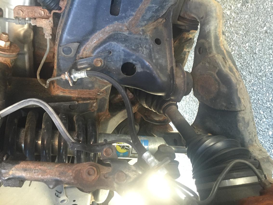

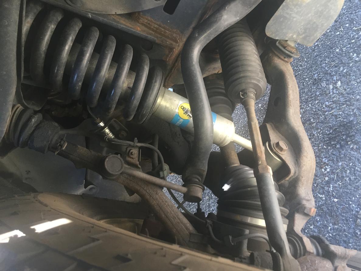

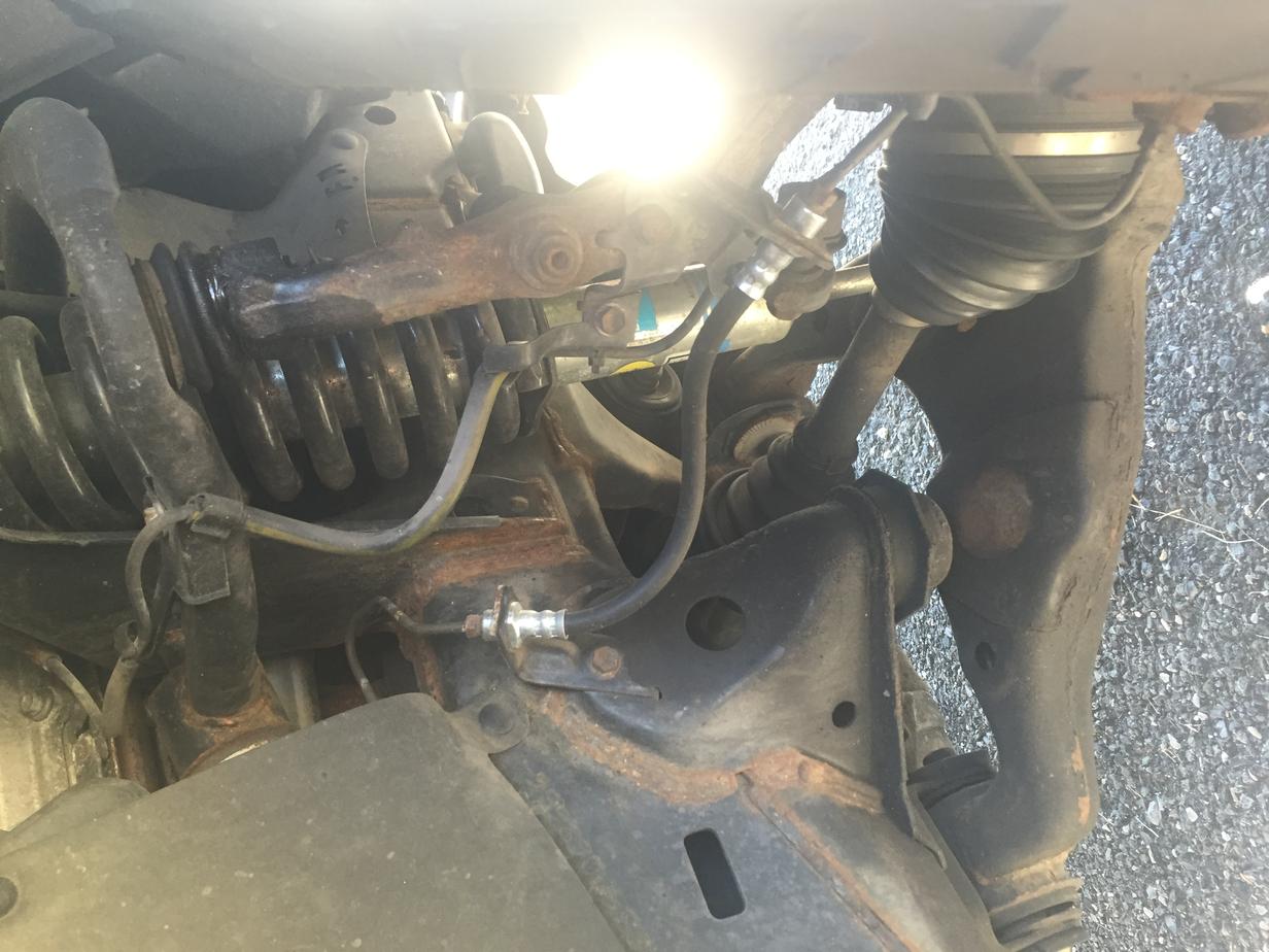

Could you post some pics of the suspension parts on that side? Maybe we could see something that's "off" that way

I'm not sure if it's the source of your problem or not, but that upper ball joint looks suspect.
^ +1, looks greasy, shouldn't be. Also can't see the sway bar bushings, but the end links look fine. I doubt bad bushings would cause you to move around like that though. I'm not even running a sway bar and my front end doesn't do that.
