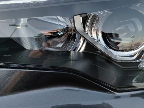

I can confirm that the 2021 Limited does NOT have LED highbeam bulbs
Here is a quick snap of a limited housing
