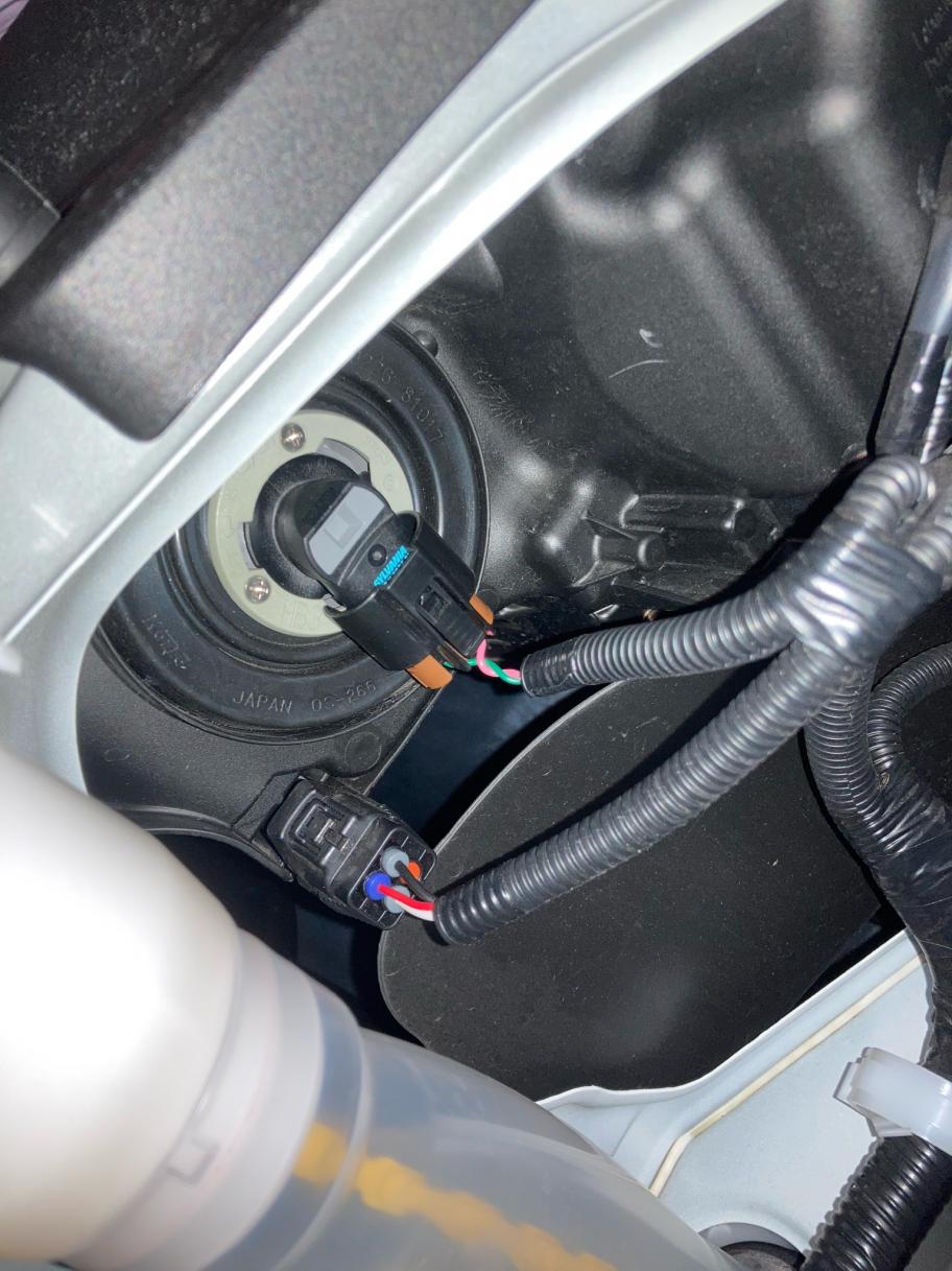

Any 2021 Pro or Limited owners around - could you post a picture of the plugs / harness into your lights? Looking to figure out how to get harnesses made so the rest of us can "upgrade" our lights.
I have a 2021 TRD Pro. The low beams, high beams, and fogs are all LED. The DRL lights are halogen but do have an option to be disabled from the Settings via access on your JBL touchscreen. I just took this photo of the harness. The twist bulb is for the DRL. The low and high beam are a combo LED and they are fantastic! Incredibly bright and have a great field of light.

Thanks [MENTION=621309]Timmbo[/MENTION]! Really appreciate it. Will pass that on to the guy I'm talking to the harnesses about. It will be awesome once we figure out how to retrofit these to older models. Those lights look great.

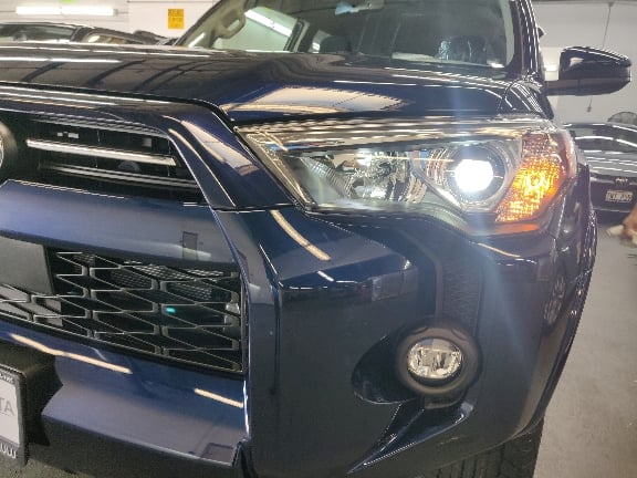

just purchased a 2021 limited and changed out all bulbs to led except the DRL's... i havent had any luck with LED's working in the drl spot has anyone found a solution to this?
