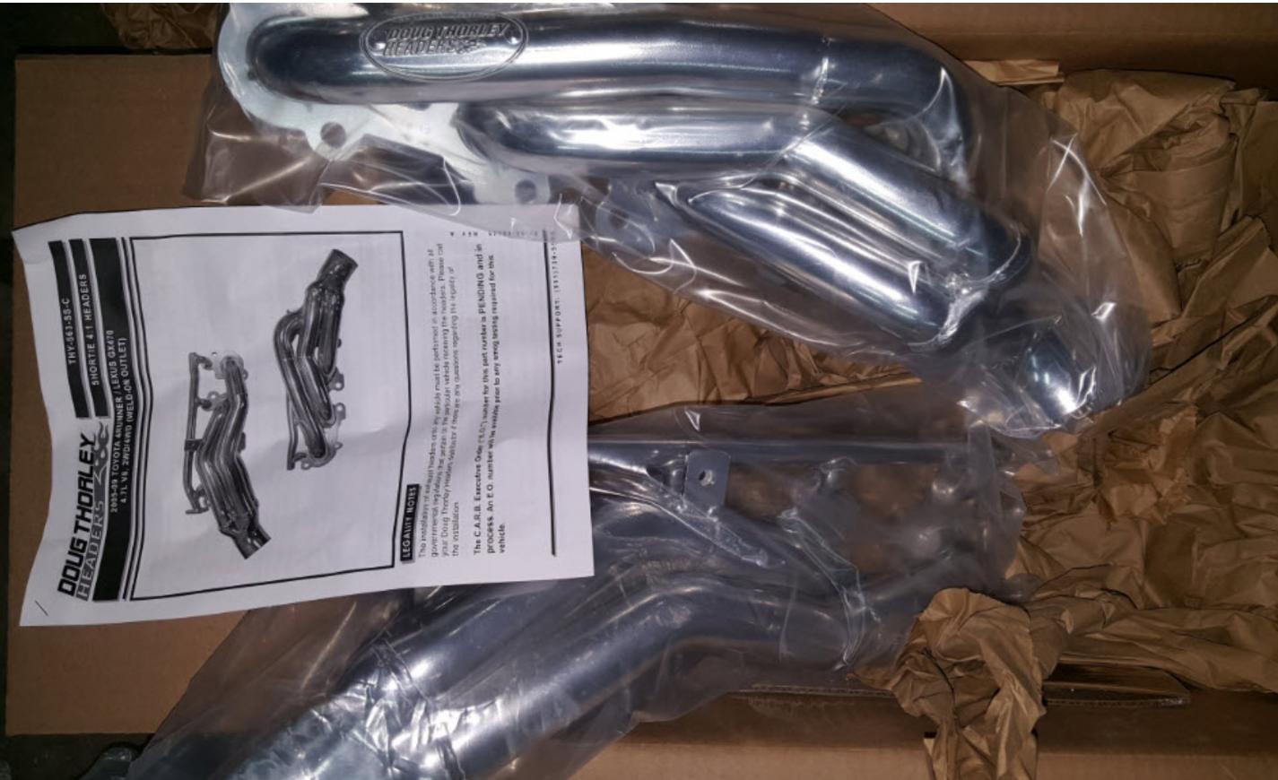

Jason HAS been reading the thread
Hey Barfy or what ever it is no one is skeered.some of have to work for a living I just got off a 96 hour stretch and didnt have time for the childrens playground. Looking through your older post it appears your from the Toronto area why not admit it your are also deceiving. Yes it does matter because the area is notorious for eating cars away regardless off make and model. 4 years 70,000 miles 4 Colorado winters in the mountains numerous trips to Moab no problems. I have no affiliation with Thorley other than being a customer, who values family owned american hand made quality products .you need to take better care of your ride, Toyota has had a few recalls for rust and frame replacement maybe you should ditch it and cry to Toyota also.
336942d1560734105-buyer-beware-doug-thorley-headers-d0619-c25-b6-dd-4-c52-a9-c6-b793-c90-b39-bc-jpg
__________________
Yes that looks like mine. I can get you guys photos but mine looks the same. This whole thread reminds me of a trump rally and I voted for trump. My point is Trump says one thing and everyone else drinks the juice and assumes that's the way it is for EVERYONE. If it was the forum would be on fire with multiple people with the same issue. These have been out now for 4 years and the guy above has had his for a long time. It's known that Canada is the worst place on earth to have a vehicle. They don't mix their salt like here in the USA with other additives and it's full strength. I don't know if that's why you hid where you were from on this post but if you live in a place like that you must look after your vehicle. My cousin lives there and his frame is taking a toll too. I did tell him about the POR15 and his dealer is doing it for him. You just really need to watch after anything up in that area as it's the harshest.

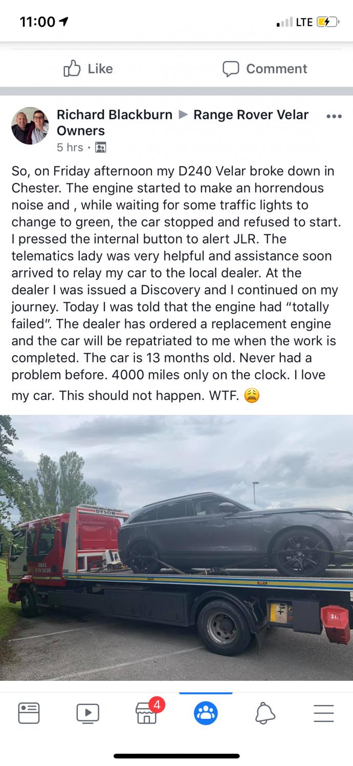

Look at this screen shot I will try to attach. Guy has a brand new Range Rover. Do you think everyone that owns this same vehicle is going to rush out and sell it because one engine blew out of thousands made? Maybe they are going to drink the juice that every Range Rover is bad. I don't think so but maybe that's the new culture we live in
