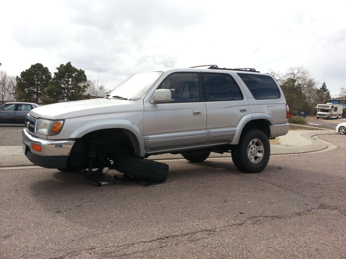

GO OEM, dont buy some cheap auto store crap or just boots, I kept putting mine off and look what happened to me. Now im spending a lot more money..
