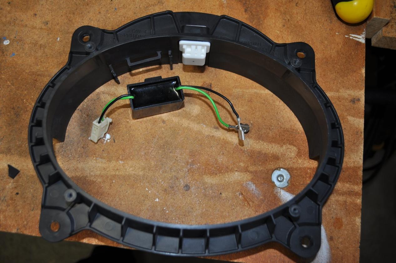

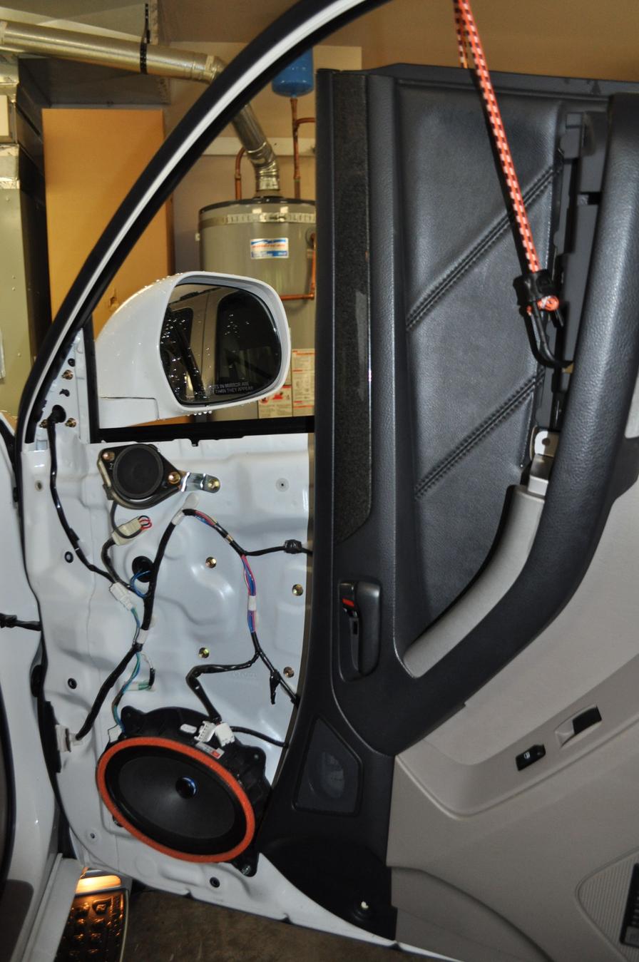

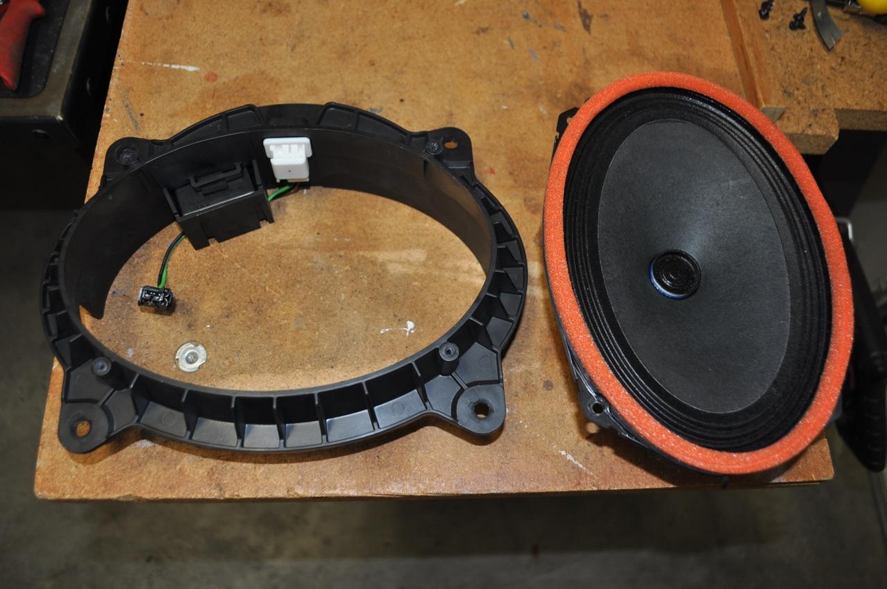

6x9 up front. Driver side door panel has one extra wiring connector that the pass. side doesn't have, and it was a bizatch to get out. Hung the door with a bungee. Anyway, unlike what some have said, it is quite easy to separate the JBL speaker from the plastic mount. The device mounted in the frame is the crossover. IN from vehicle at white, out to speaker at black.
Fitment

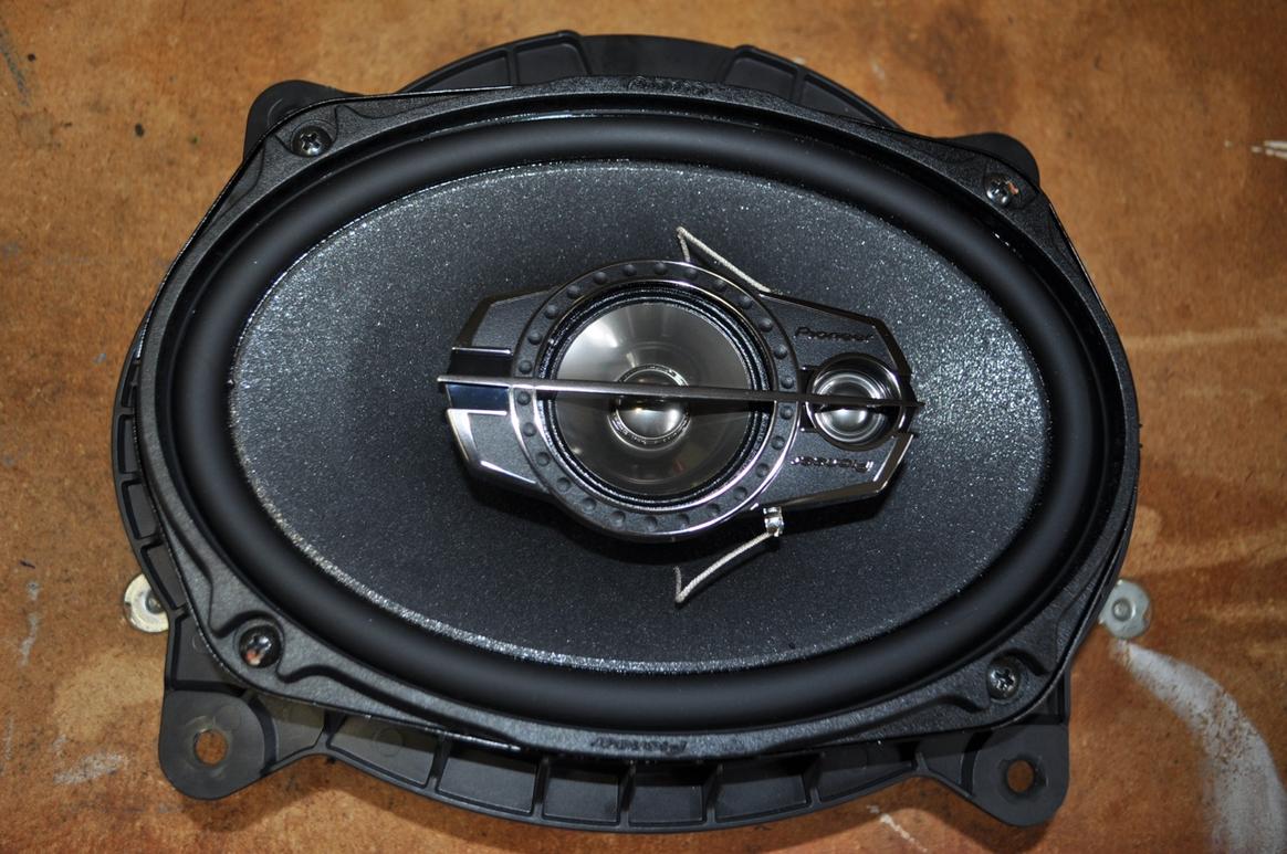

I tested the new Pioneer and the old JBL with the crossover, then plugged straight in, no crossover. As you can imagine, being a 3-way it sounded horrible with the crossover. The unit itself pops right out under finger pressure. Then a couple snips with a bigger wire cutter and the little box was gone too. This was necessary to fit the Pioneer 6x9.
No need to remove the white connector. More on this in a moment.

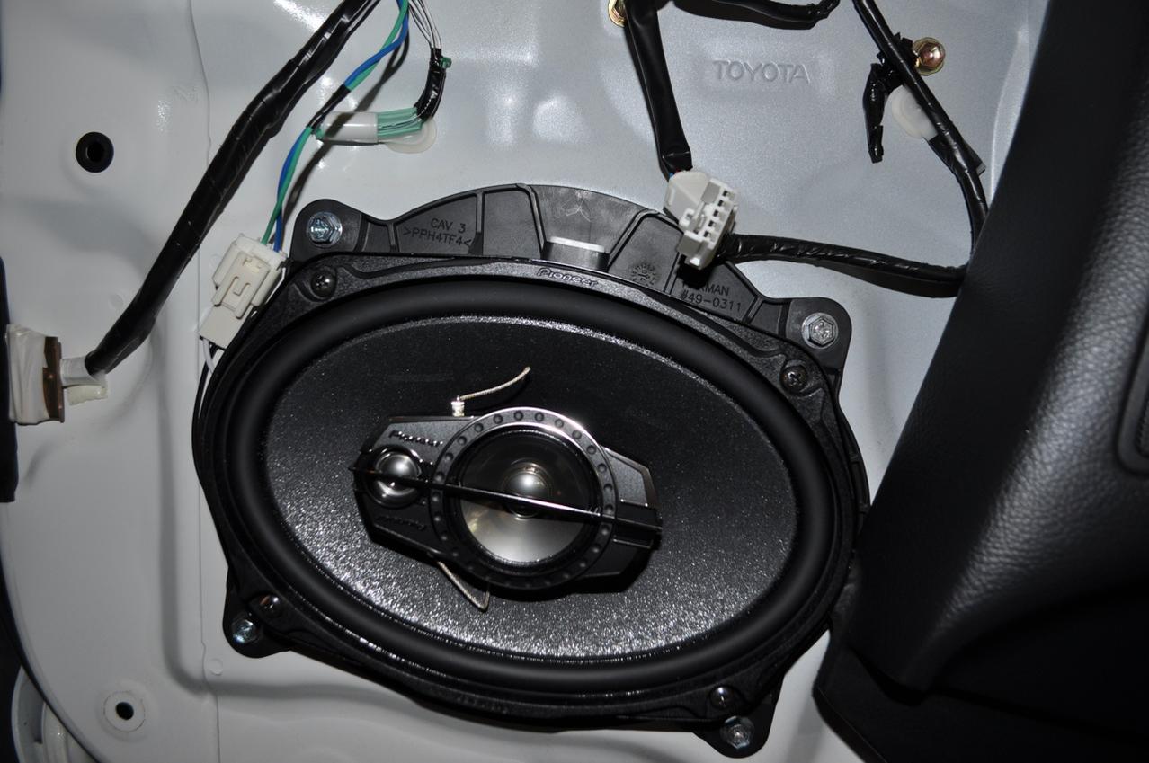

My new Pioneers matched the OEM mount holes perfectly. No need to buy an aftermarket mount frame!
I did buy the Metra 72-8104 plugs and they worked great. The go direct from the car harness to the speaker terminals.

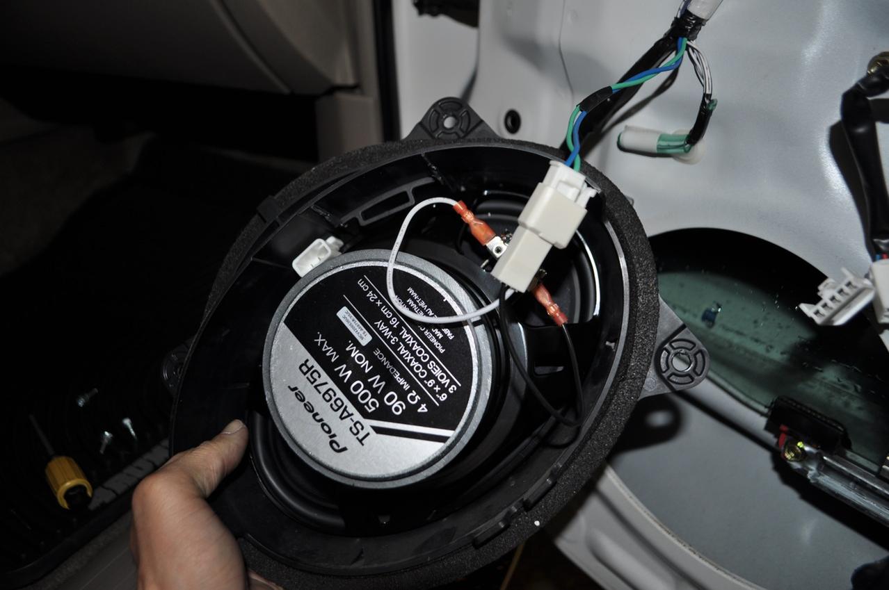

Here are the Pioneer A-series 6x9s installed. Left side of speaker you can see the Metra going behind the mount; these wires end at the speaker terminals.

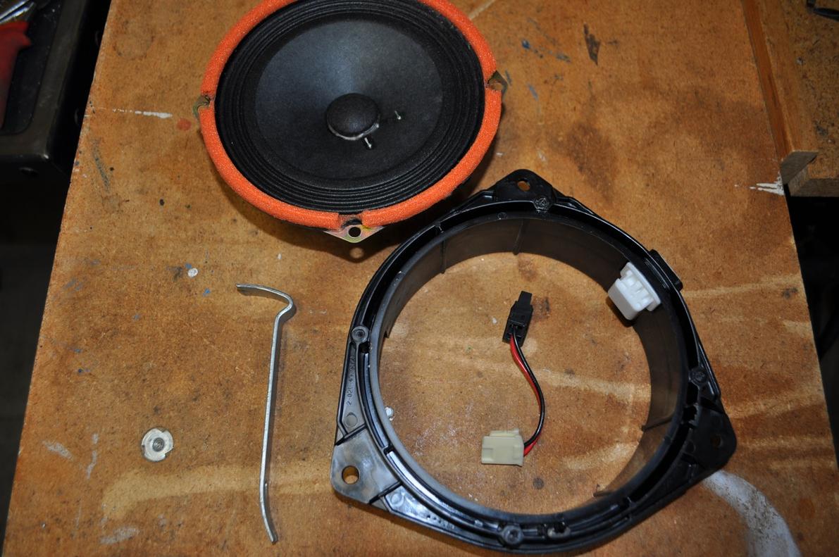

Rears
Somewhere I thought I read the rear doors were 5.25". Nope, 6.5". Oh well. here is the stock JBL, again easily separated from the OEM frame. Will finish this thread tomorrow when the 6.5s come in.

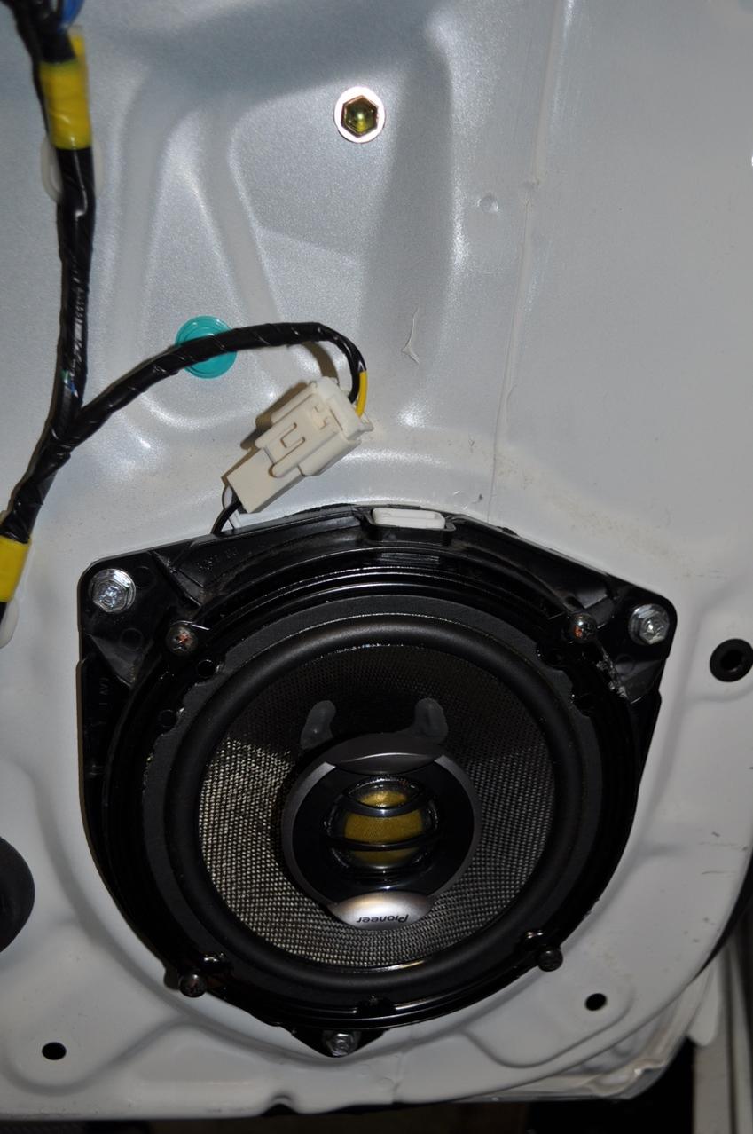

Got some Pioneer TS-D 6.5's in back. They did not QUITE line up perfectly with the frame mount holes, but close enough. Done and dusted ten minutes per side. Used the Metras; I had 'em so why not use 'em versus cutting and crimping and all.
Sounds better, maybe not incredibly better but way better than those single woofer rear drivers!
