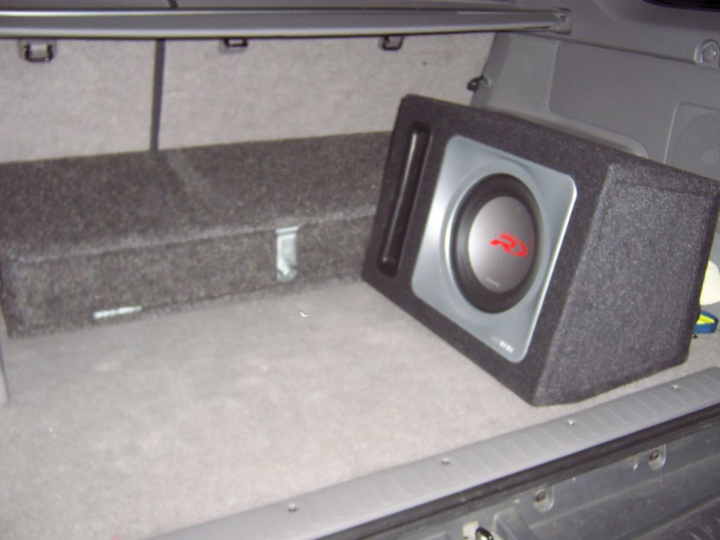

Got any pics of your install or can you explain it in more detail? I'm interested as you're using the same Type-R sub I'm looking into.

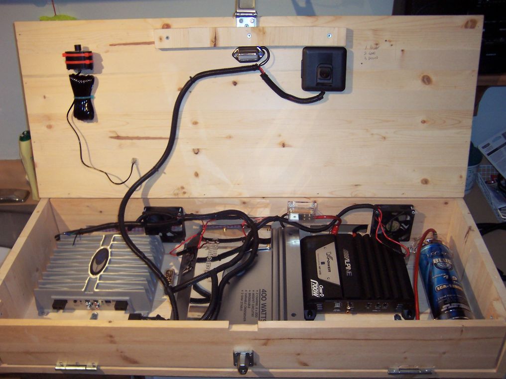

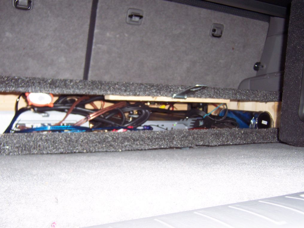

I built a pine box to hold 3 amps + cap. Installed 2 PC 12V fans, one sucking air in, the other pushing it out. Also added a small 12V light for convenience. Covered it it black auto carpet and then bolted it to the floor from inside the box and locked it. The sub is in it's own box.

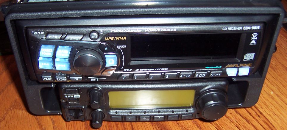

Alpine type-R 40 W RMS in the 4 doors. I guess I like Alpine as the HU is also Alpine. This pic is before installing, but you get the idea. That's a HAM radio. Wish I could do some of that fibergalss work to pretty the dash up a bit.

Knowing the punch that the Type-R sub has, I can't imagine it being mounted in that little factory space without the panels vibrating like crazy.
