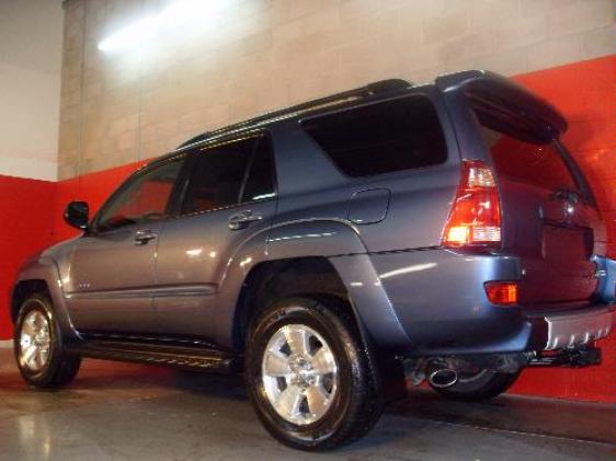

OK - installed a TRD V6 CAT back exhaust - these have been discontinued so there are some specials out there. Love the sound, and the TRD is a direct replacement for the OE muffler/tailpipe. Removal of the factory exhaust was a little more challenging then I expected as the bolts/nuts on the tailpipe connector flange were rusted away to nothing - couldn't even get a wrench on them SO without access to a cutting torch, I used the next best thing a reciprocating saw and a metal cutting blade - cut the old exhaust right out!
Not to hijack this thread but here's my friend's V8.
