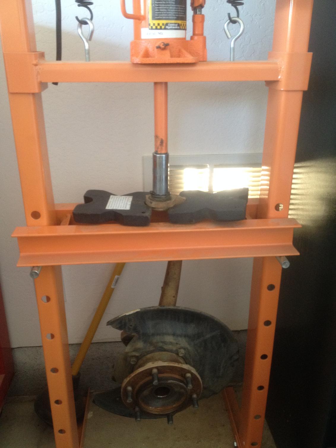

Shop press is the way to go
I definitely agree that a shop press is the way to go. I've never tried it any other way though.
Just like [MENTION=126408]4everun22[/MENTION] said, if you don't have a press - go get one. It's worth it to save all the time and headache. I got the harbor freight special on sale for $80.

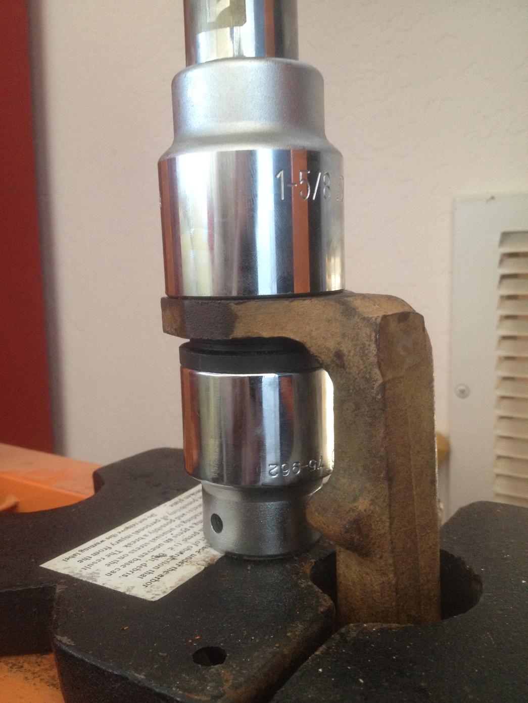

So when I did my uppers, they were off and back on in about 5 minutes. No hassle.
Pressing off - then back on:

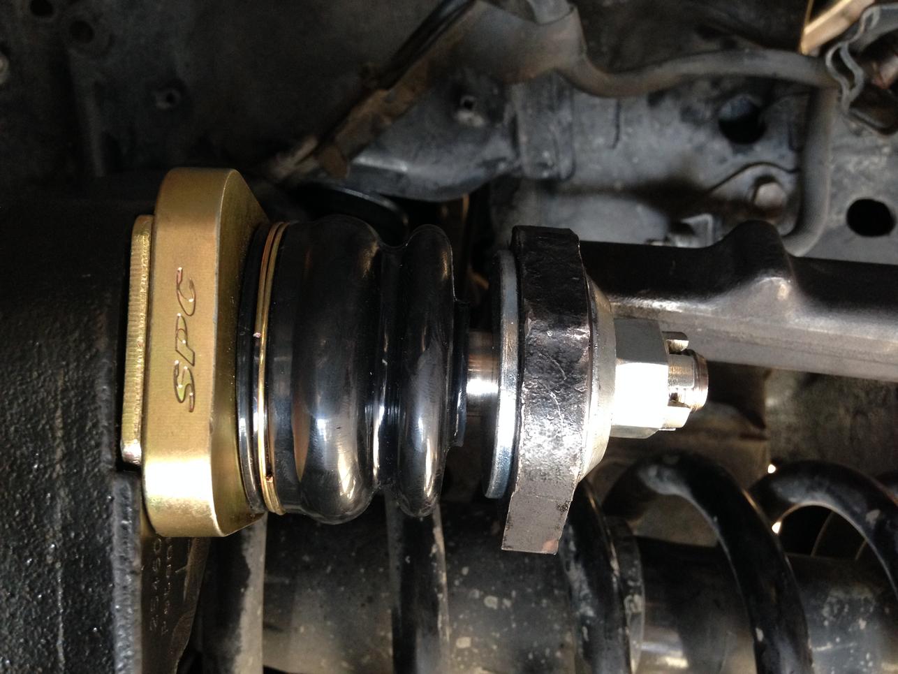

Hey guys! Is the space between the metal insert and the ball joint boot normal or no? is doesn't look right to me.
