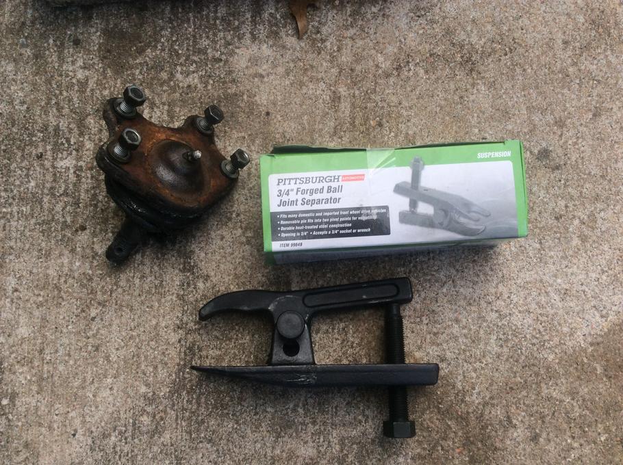

Here's the tool that got the sucker out....HFT to the rescue! Now to figure out how to get the bushings out of the control arm....Am replacing them with EnergySuspension bushings....Anyone ever do this?
