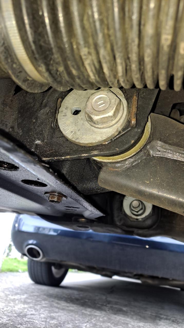

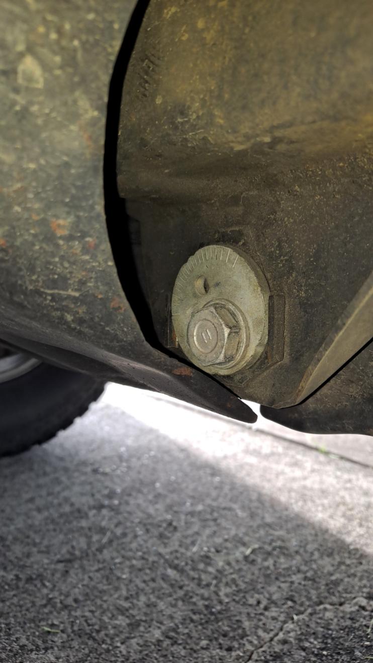

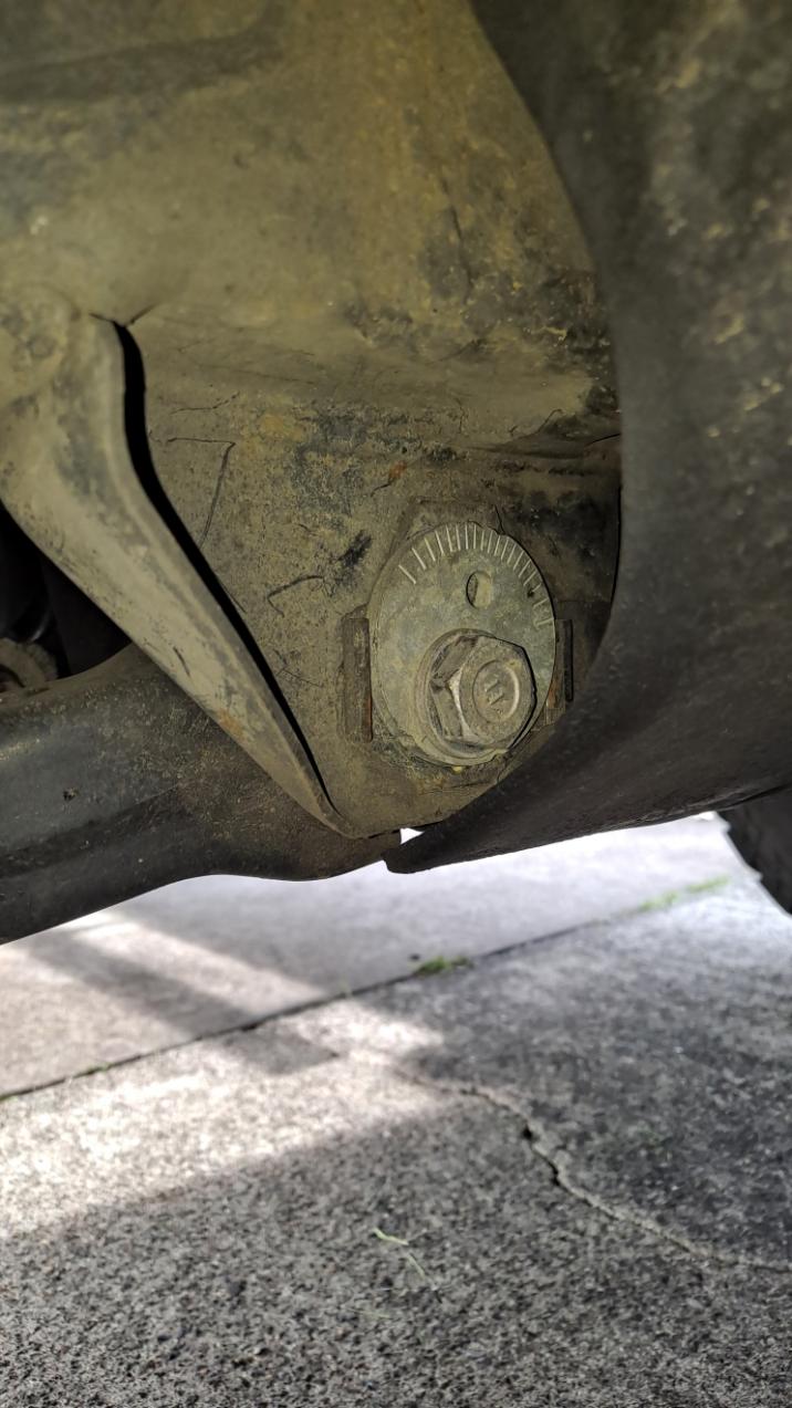

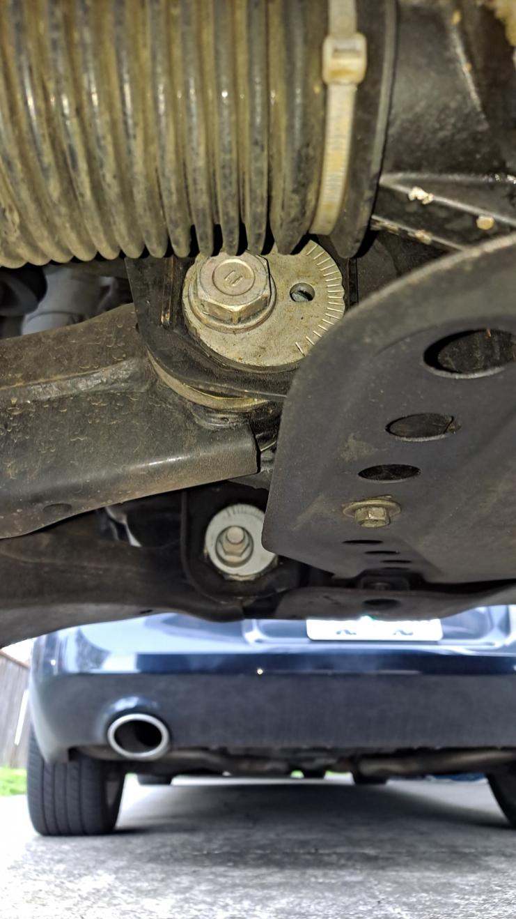

could you post pics of the cams?
Thanks!
Here you go:
1st Pic is Passenger side Front Cam
2nd Pic is Passenger side Rear Cam
3rd Pic is Driver's side Front Cam
4th Pic is Driver's side Rear cam
