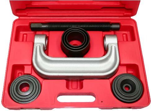

So I've had Toyota upper ball joints in my parts box for a couple of months now and I decided to give it a try today at replacing them. I followed this link that can be found in the maintenance and tutorial thread in the sticky's from TTORA. I've got the UBJ separated from the upper control arm and the boot removed. I rented this from Auto Zone...
The only problem is it won't fit in the wheel well. I think i'm going to have to remove that whole vertical arm to get that particular kit to fit. Has anyone else run into this problem or come up with some sort of solution to pressing the UBJ out of the knuckle and then back in? Is there a better tool for doing this? I'm kind of ready to throw my hands in the air on this one. :shrug:

You'll save yourself a lot of heartache and get plenty of room to work if you just pulled the entire spindle. I pulled out the spindle and used a large vise, cheater bar and small sections of pipe to press the BJ back in. Not the best way but it worked.
Worst case if you pulled the spindle you can take it to a shop that has a press to do the swap.

For the tool pic you attached, you need the extra kit, which Oreilys has but Autozone does not. I have run into this problem with AZ before for ball joints (not for the 4runner).
Can you post a picture of what it is that O'Rielly's has that Auto Zone does not? There is an O'Rielly's 100 yards from the Auto Zone by my place. I'm not sure what removing the entire spindle entails, but I may go this route if the kit you tell me about from O'Rielly's doesn't do the trick.

Take the whole knuckle out first if you are going to use the tool IMO.
Oreilys has nothing more than more cylinder sizes to choose from to gain leverage to press the joint out against the knuckle, then back in. Will any work on the 4runner? That I do not know. I would think so.
Alright, I've given it a try 3 days in a row now with no luck. Looks like I'm going to have to pull the spindle. Just to be clear, from studying it it looks like I need to do the following to get it off:

I used the fork to get it out of the UCA. That took 2 minutes. It has been out of the UCA for 3 days. Neither of the 2 tools I've tried worked. It's going to take some sort of hydraulic press to get that out. I had the long arm puller with 3 pieces of 1/8th inch steel in between the puller thread and the 36MM socket (see link), and it still bent the steel. That "D" word ball joint would not budge even with my 26 inch breaker bar.
