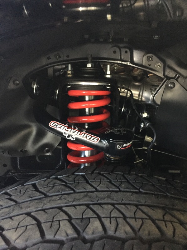

I had Camburg Balljoints with my old 5th gen setup with Toytec/Bilstein lift and love them. I have Kings on order with Toytec rears and the same Camburg Balljoints on order for my new setup.
