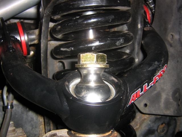

I'm using them in salty winter conditions. If you're driving in winter salt you should bring your car to the car wash at least once a week whether you have uniballs or not. People who dont...well their frames are shot. I keep a can of teflon spray in the truck & spray them after a wash.

A spray can of lube is smaller than a quart of oil, a gallon of antifreeze or a gallon of windshield wiper fluid which many people carry around in the backs of their cars or trucks. Spraying two uniballs is easier than checking & filling up 4 tires with air.
