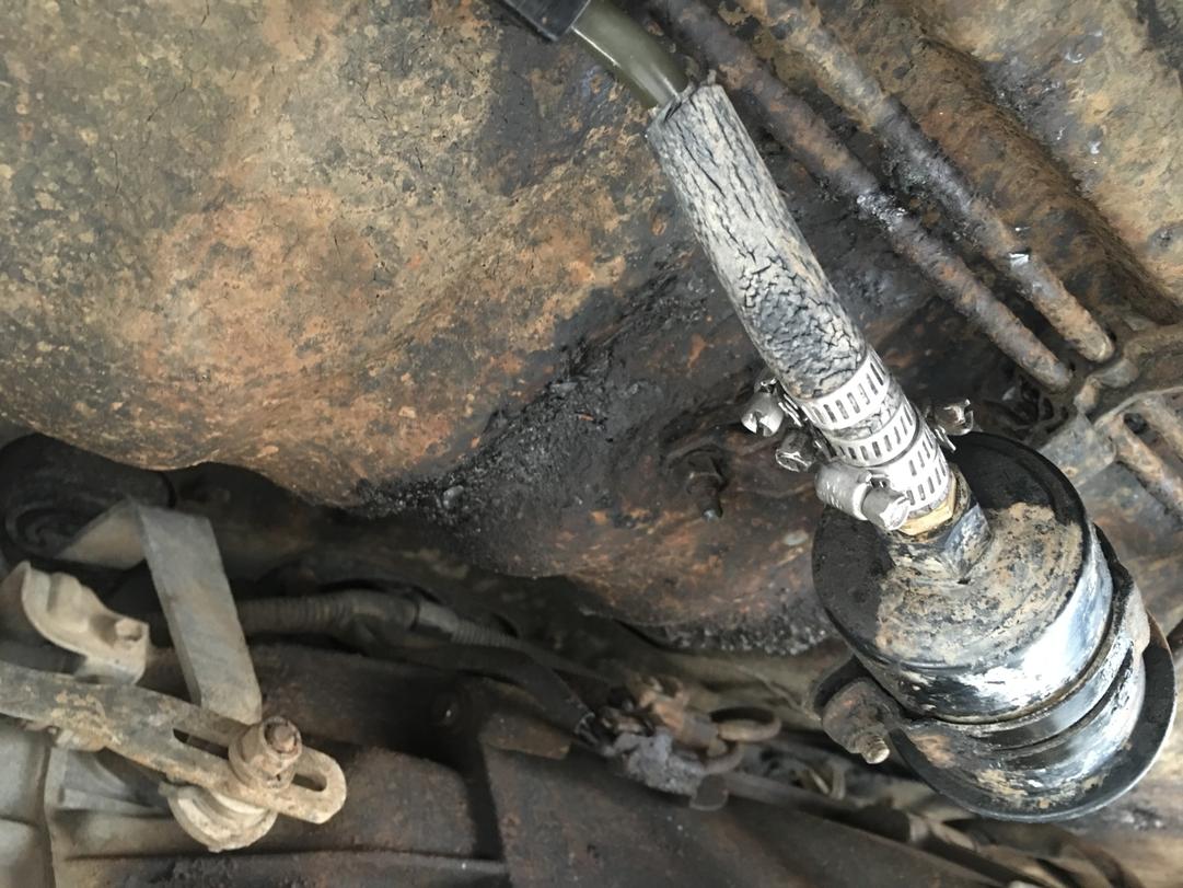

So I ended up cutting the metal fuel line between my fuel filter and the engine due to an unsuccessful fuel filter replacement about a year ago. I fixed it by putting a new fuel filter with a fitting in one end and then butting that up next to the cleanly cut metal fuel line, and taking a piece of fuel injection rubber hose and clamping it around to form a seal. It's now leaking. Does anyone have a good solution?

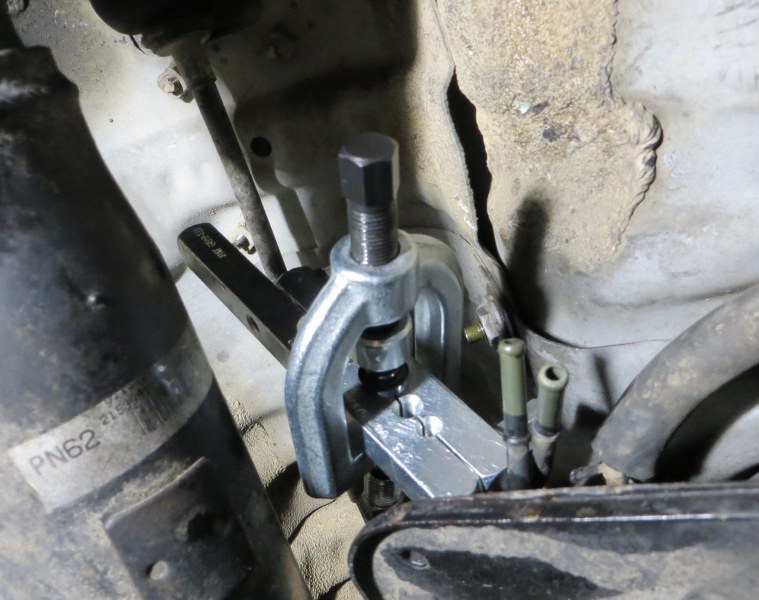

FWIW I have had good luck with this flaring tool. I would recommend practicing on some scrap tubing first.

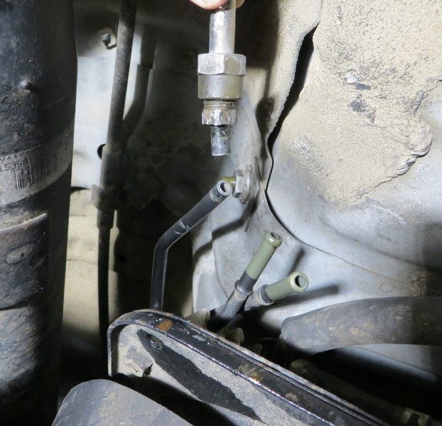

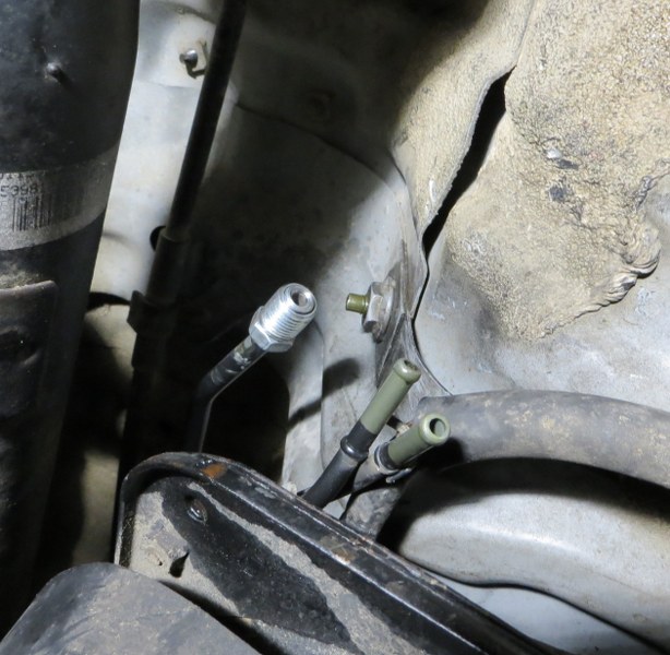

A while back I was replacing the rubber line near the fuel tank, and the threaded fitting going into the rubber line was completely seized up. I had to cut the hard line. I managed to get some sections of hard line with fittings out of a junkyard 4runner, and was able to install one of those fittings and re-flare the existing line to fix this issue. The line ended up a tad shorter, but I was able to make it work. Not a fun job, but its do-able.
so about a yr ago you did the fuel line rubber hose repair ? well if so that hose is not rated for fuel !

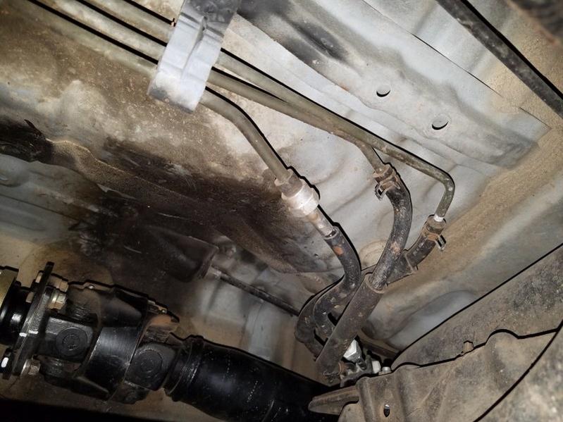

[MENTION=115592]bugman-74[/MENTION] What are the other two hard lines pictured? They look bubble flared vs your double flare. My fitting on the tank hardline to filter hose was double flared as well, but I'm curious about the two other lines. 3RZ?
One is a fuel return, and I believe the other is a vent (to canister). Both just take a rubber line and hose clamp. 5VZ

I was referring to the post #1 "So I ended up cutting the metal fuel line between my fuel filter and the engine due to an unsuccessful fuel filter replacement about a year ago. I fixed it by putting a new fuel filter with a fitting in one end and then butting that up next to the cleanly cut metal fuel line, and taking a piece of fuel injection rubber hose and clamping it around to form a seal. It's now leaking. Does anyone have a good solution?
that picture of that rubber hose is deteriorated due to its not being fuel capable. that hose manufacturer may say it is but it clearly failed because it is not. I have a 1984 vehicle with fuel rated hoses that look new they are original 1984 vintage hoses.
where did you buy these? who made them ? this would help others so they will not purchase them . that is very dangerous .
using those hoses on a boat engine would make it a very bad day.
