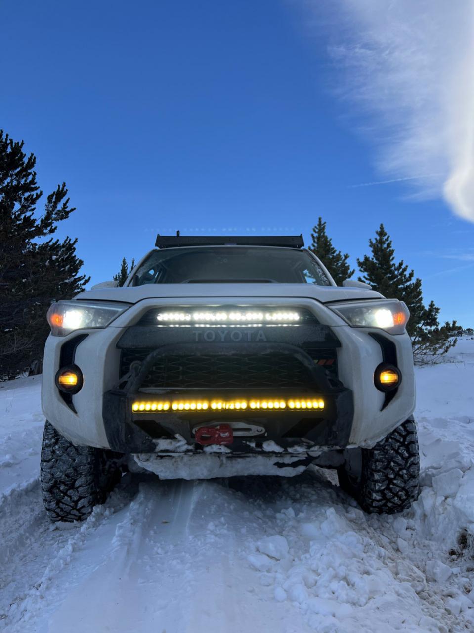

Does anyone happen to know what lightbar is in the upper grill of this 4Runner? It looks bigger than a 20” and seems to fill the space very nicely! I think it would be an awesome Aux high beam!

It's a 4 segment bar, so it's roughly 24-26" length assuming that the optics are about one inch in diameter each. Couldn't tell you more than that.
Yeah. And the bottom one is obviously 30” with 6” segments. I just don’t know of a 24” lightbar. It looks like it matches the bumper lightbar though…

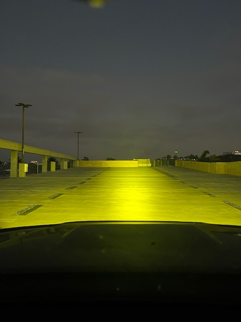

so the lights im running is a combo on both upper and lower, but it's really 80 percent spot, 20 percent spread.... You can definitely see the spot light cut off in the upper grill, and not alot of light scatter due to the grill and bumper cutting off the light... Whereas, the lower grill area, you get better light dispersion (30 inch in low profile/hybrid bumper). However, there is enough light scatter that there is literally a wall of light in front of me and far off in the distance. Both light bars are aimed close to the same focal point.
