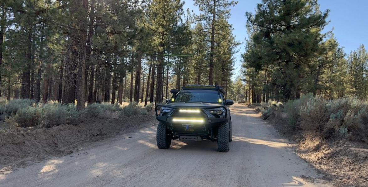

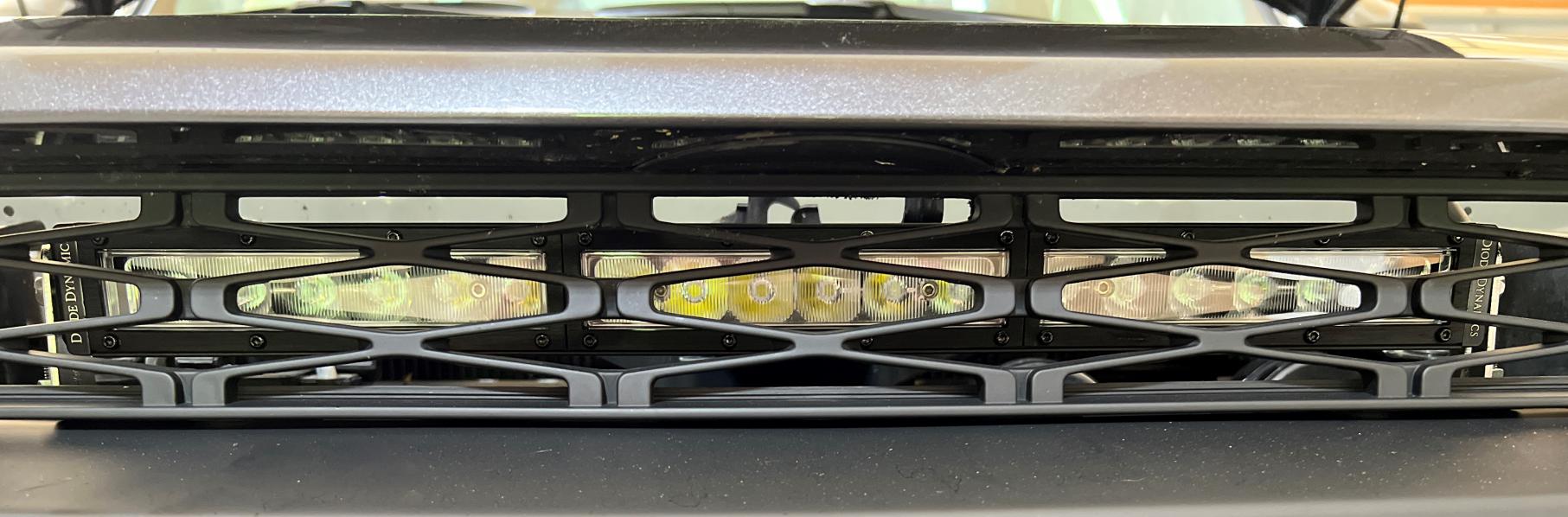

OK, 30" light bar added to 20" light bar. Have not had it out anywhere dark, yet.

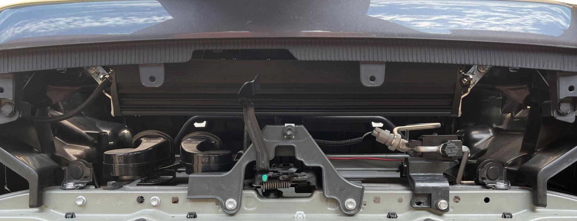

Has anyone mounted the DD 18" light in the upper grille? What brackets did you use?
Just received mine, and eyeballing it, the mounts don't appear they'll be close enough to line up with factory holes. I'll take a better look this weekend.

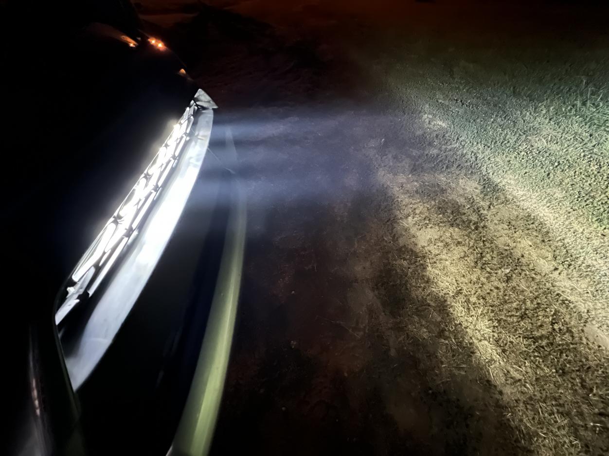

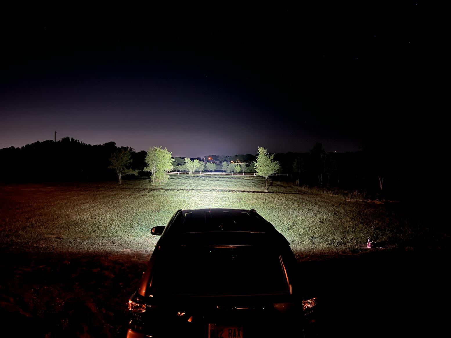

If you can zoom into the picture of the field, the brick house on the other side of the dirt road is 600 yards away! The fence is 100 yards. This thing just slaps! Since I have a 22 ORP with the TSS sensor in the lower grille, look at how this fits! Diode Dynamics for the win!
You might need to make your own.

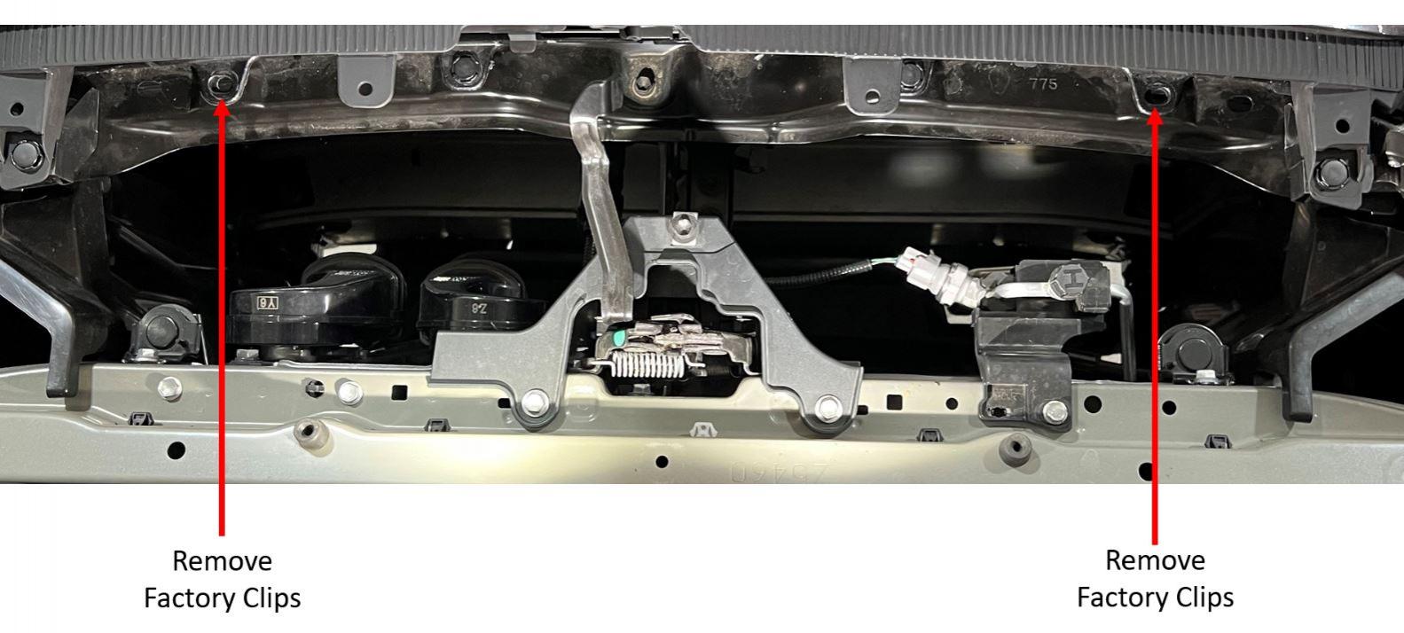

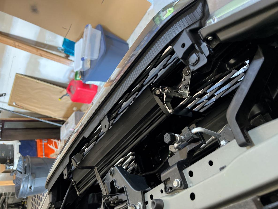

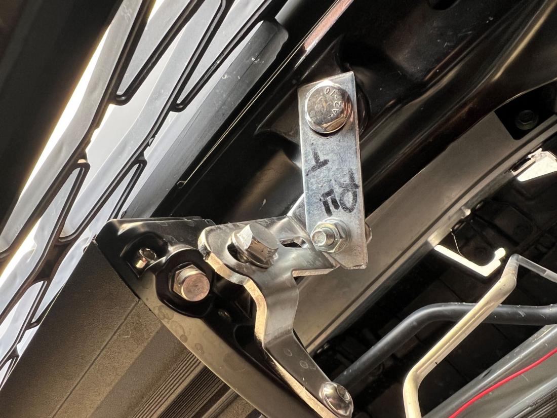

OP,

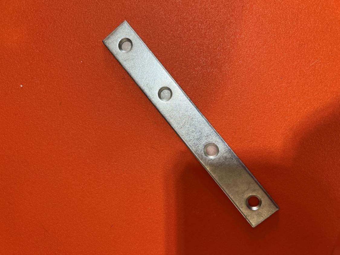

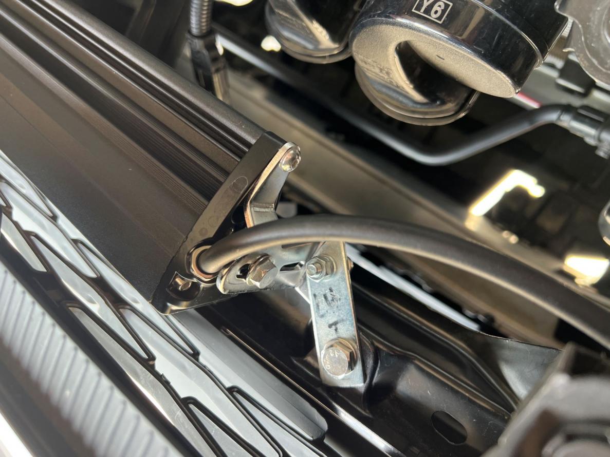

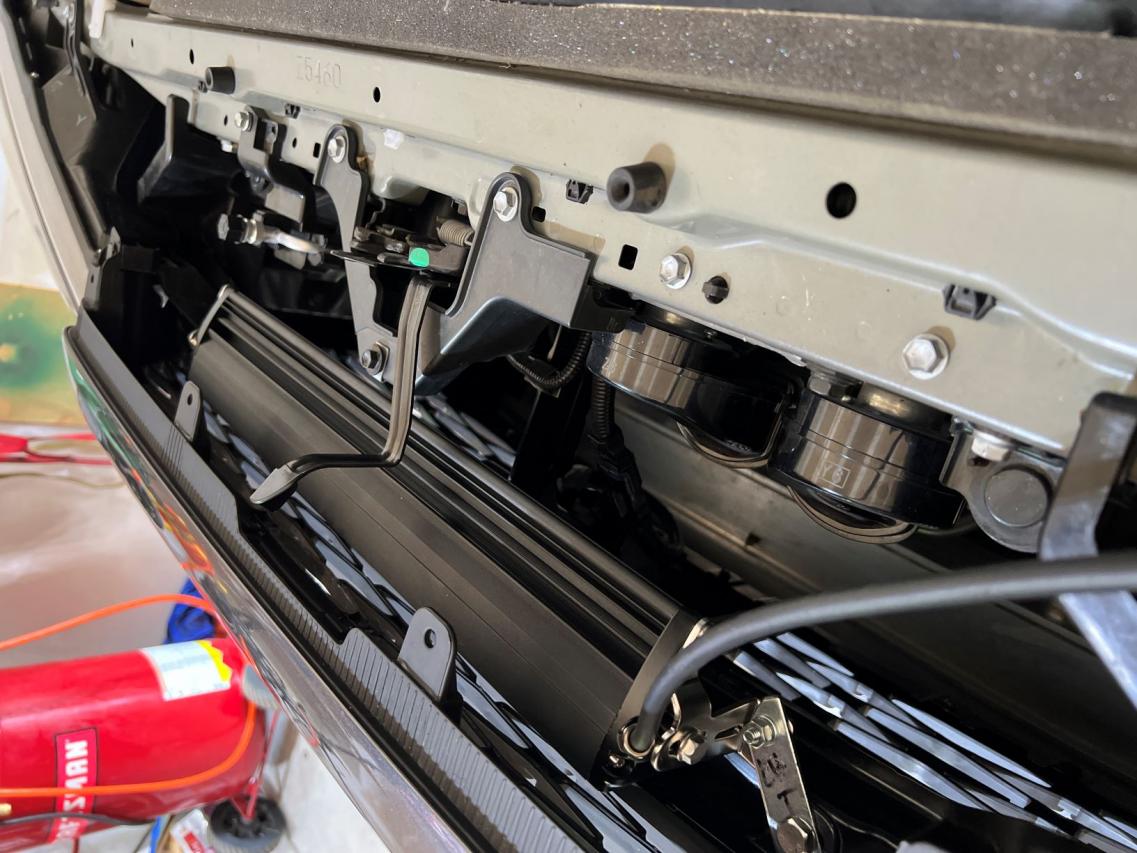

Yes, mine is done, had it for a few weeks now. Absolute beast mode! Please see my install pics. I used a mending plate as my bracket. It worked perfectly with the factory lower grille holes that have the basic Toyota push clips in them. Just remove and go from there. Let me know your thoughts. I just did some basic measuring to do the alignment of the bar. As you can see in a few posts above just how bright this sucker is! Enjoy!
