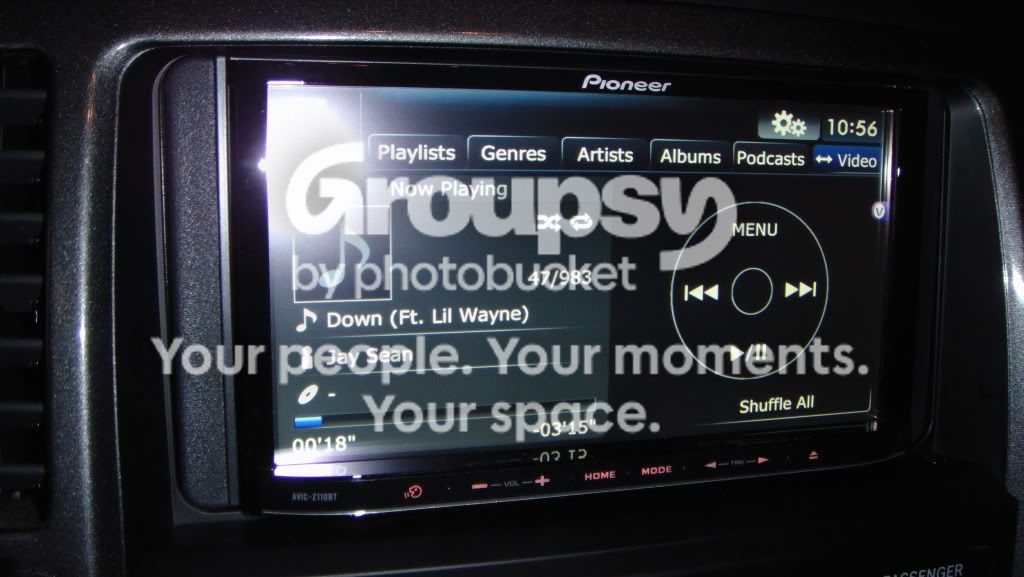

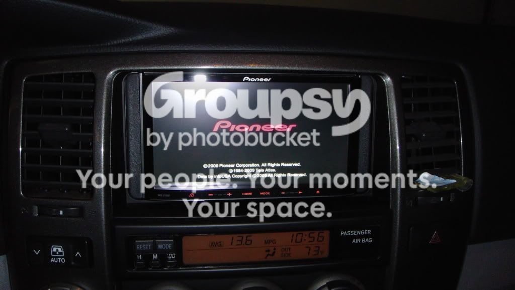

my buddy that does car audio got a trim piece that isnt as nice as the urbanrunner trim...but this will do for now....
install was easy..got the bluetooth for the phone..ipod cable..and back-up camera..

Thanks for the pics. Looks great. The trim ring looks pretty good to me....which one is that?? It doesn't look like the Metra one nor the Scosche one that I bought.

my ipod is in the center console....not sure which trim kit that was...not sure of the brand...but its two separate pieces that bolts onto the side of the hu...
