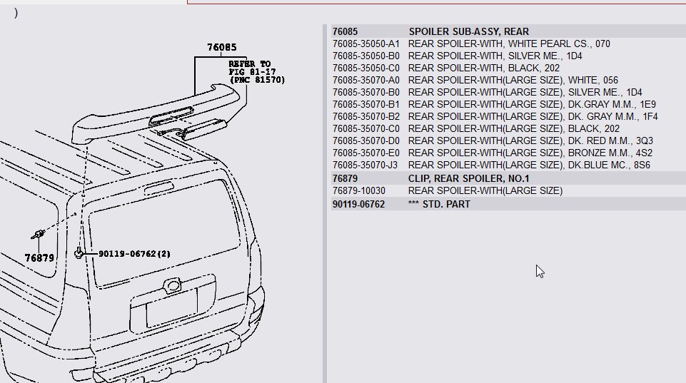

I have a Black 2008 Urban Runner in the body shop for repairs which include replacing the rear spoiler. I know the Urban Runner has a specific rear spoiler and I think the shop may be ordering the wrong one. Searching on the web, there are comments made on other sites that the Urban Runner spoiler is just the non humped one from 03 to 04. Can anyone confirm this?
The estimate lists part # 7608535070C0 which is listed as Spoiler Sub-Assy, RR area Spoiler-With (Large Size). This sounds like it would be the humped one.
I found part # 7606535050C0 which is described as above but without the Large Size designation. This sounds like it would be the non humped one.
Does anyone know if the Urban Runner spoiler is simply just the non humped spoiler or is it really a different spoiler specific to the Urban Runner?
Thanks
The Urban Runners only came in 3 colors, so it's a safe bet that the first three part numbers shown are for the slimmer urban runner spoiler.
