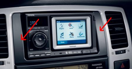

Other question, the plastic dash part, where the tomtom is mounted have some ID part?? , I am looking for this OEM parts, but the dealer tell me that he need the part number,

As for that trim ring on the urban runner, I can get you the P/N, if there is one, but I doesn't fit with the 8120. It may fit with other stereos though, but I doubt it. Seems like it was designed around the Eclipse/tomtom deck.
I actually tried to see if it would fit before ordering the other one from Crutchfield.
