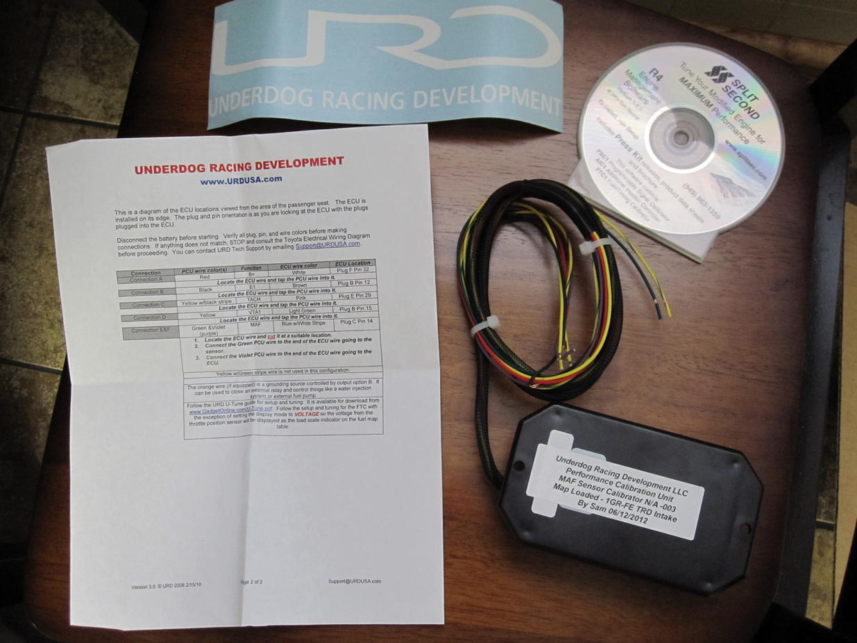

What comes in the box. Tuning software (CD), decal, "Unit", instructions and pin layout (on back of instruction sheet)

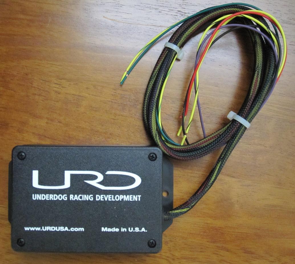

Unit itself. Has hole to mount on both sides. Just a funny angle pic

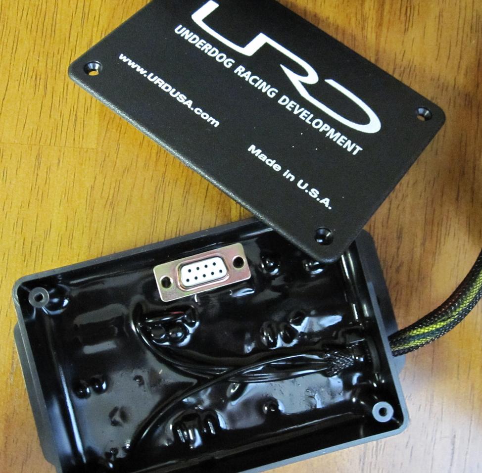

When you unscrew the box you find the serial port where you connect to tune it. They make serial to usb cables if your comp. doesn't have serial connection
