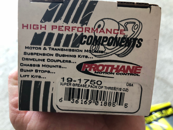

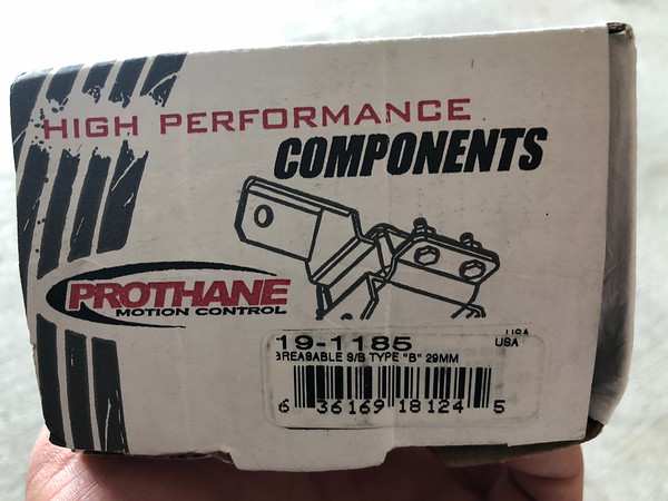

The parts I ordered :
-Whiteline W21053G bushing pair
-Prothane 19-1185 Red 29 mm Universal Greasable Sway Bar Bushing fits B Style Bracket
-Prothane 19-1750 Super Grease Tube
The grand total from amazon was under $60
It took a total of an hour to install front and rear. The rear are non greasable and do not require grease. The front is a bracket and bushing with grease zerk.
From what I read I expected some “flatter” cornering. I had also read that it would reduce wind shear but I had doubts about that.
What I experienced is indeed flatter cornering and MUCH improvment with wind blowing me around on the highway. I also notice almost zero bump steer on the highway. For the cost, I highly recommend this project. This thing drives straight as an arrow with zero effort.

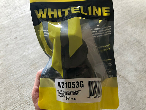

Why are the bushing in the bag black but the install pics are red bushingsm
[MENTION=153970]Soneill[/MENTION] Blacks are rears (19mm)
**Which is gnarly, b/c my rears were 21mm...
