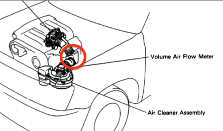

I desperately need to find a name and part number for the part highlighted in the pic attached.
I live in the Dom Rep and spent a whole day trying to find it.... drove hundreds of miles , got sent from one place to the next but failed to find the correct part.
I need the Toyota part number so I can order it and get my trusty 4Runner back on the road!

if your looking for the part in between the aafm and the throttle body it is called the air elbow but i dont know the part #
air elbow

Hi 88T4RE !
Thanks for the link to toyodiy.com, i spent some time studying the diagrams and found the culprit!....
It's simply called 'Connector, Intake Air' and the part number is 17861-65020.
No wonder I was having difficulties finding it!...
Anyway, THANK YOU for your tip !... Best wishes for this festive season !
